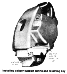

    I think the 74 doesn't use the support spring clip and retaining key. I will try and get a pic of my 74 tomorrow.

    I thought wrong. Looking at both 74 and 76 spindles, calipers, caliper bracket and the whole nine yards, I don't see any difference between the two years. I didn't remove my tie rod to see if it fits the later spindle...but I did try a'71 tie rod and it appears to fit.
