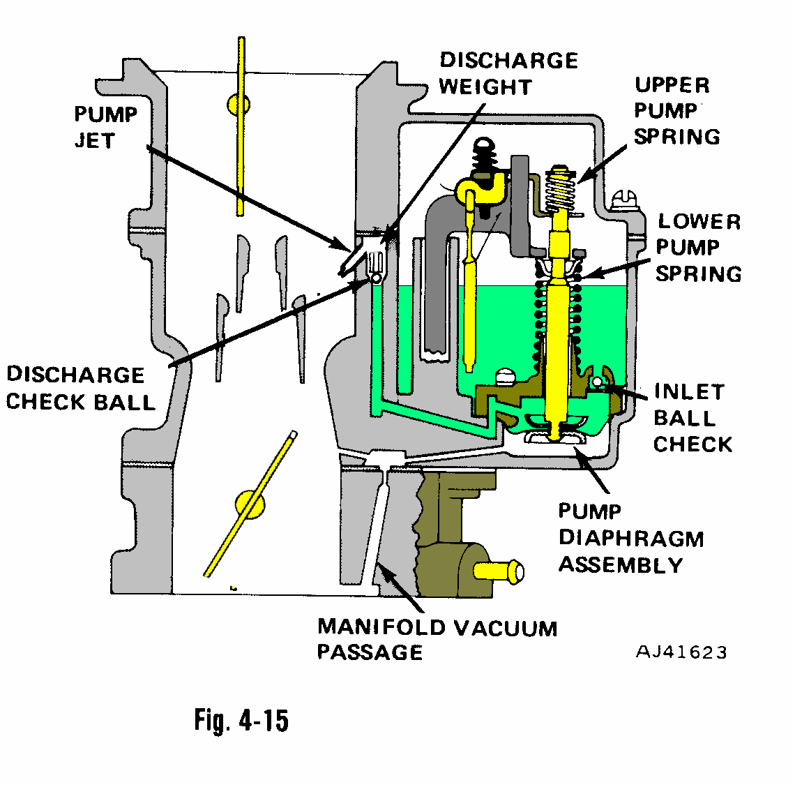

    Here's the one for for pump function... Usually no "squirt" issues are related to upper pump spring incorrectly installed... Could also be related to problem in discharge circuit(weight, ball, plugged passageway etc)... If inlet check ball is missing the pump won't function...

    I saw that same GIF but did not see any fuel coming from there. When the engine is running there is an obvious squirt of fuel as shown on the GIF I posted.
    This evening I was looking at it again with the engine cold and located the 'pump jet'. I also did discover that there is a small squirt of fuel when I slowly applied the throttle. And the engine started right up after I did that. That jet is further down the throat than I was expecting and my viewing angle might have contributed to me not seeing it earlier. Would the speed at which you depress the gas pedal have any effect on the function of the pump? Wouldn't think so but it is the only thing I did different tonight.

    The quicker the throttle is opened the faster the stream should be...
    I dunno why it works opened slowly, sorta points at linkage/spring or maybe the check ball I mentioned earlier... It's no doubt going to have to be opened again...
