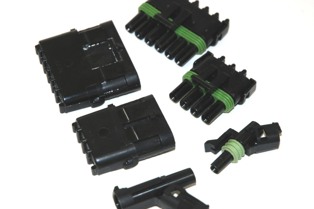

    How did you hook it up to the existing wires? Did you cut off the big existing plug? I wonder if I could make a pin out adapter?
  4. 71gold
    26,589
    2,935
    the connector at the top right comes from the gauges.
    then I took the wires from the cluster plug and changed them to these. get the correct crimpers and connector removal tools for these plugs. it was so simple it seemed the car was wired for digital gauges from the factory. I would say with any mechanical/electrical skills at all it's a 3 on a 1-10 scale.

    Were you able to de-pin the original connector or did you cut the wires to pin into the new plugs?
  7. RMiller
    RMiller My name is Rick
    Dec 12, 2009
    4,132
    1,160
    538
    Kennewick, WA
    1971 Maverick Grabber
    You have to cut the wires.
