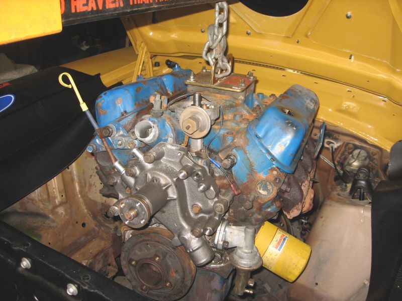

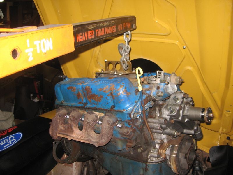

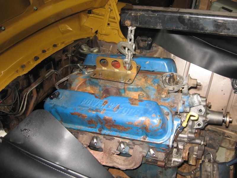

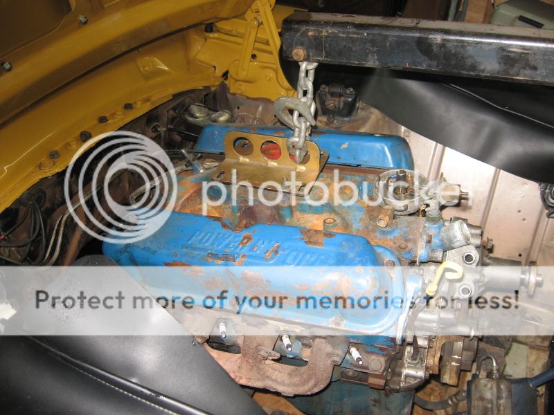

  13. Krazy Comet
    7,718
    2,433
    Well it can be done with hood in place while lifting engine straight up(yeah the hood is open almost as far as possible)
    Boom isn't nearly as close as it appears, had at least four inches...
