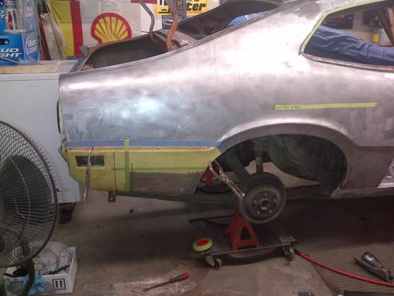

    heres how someone else cut a 1/4 out lots of work but the best way IMO
