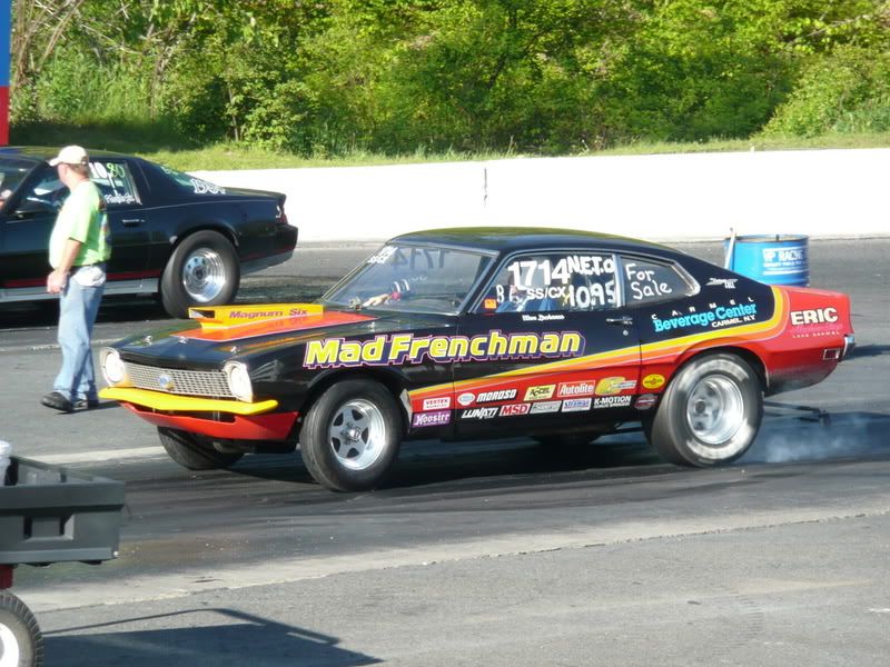

    Mad Frenchman: 303" straight six, high tens in a quarter. Told me he had a better 300 that would push it faster too.
