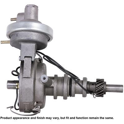

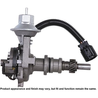

    this is the regular autozone distributor points type and the onde behind is the electronic one
