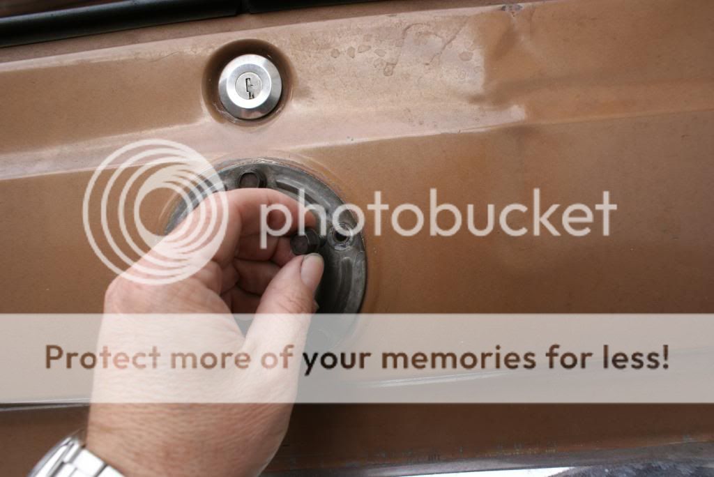

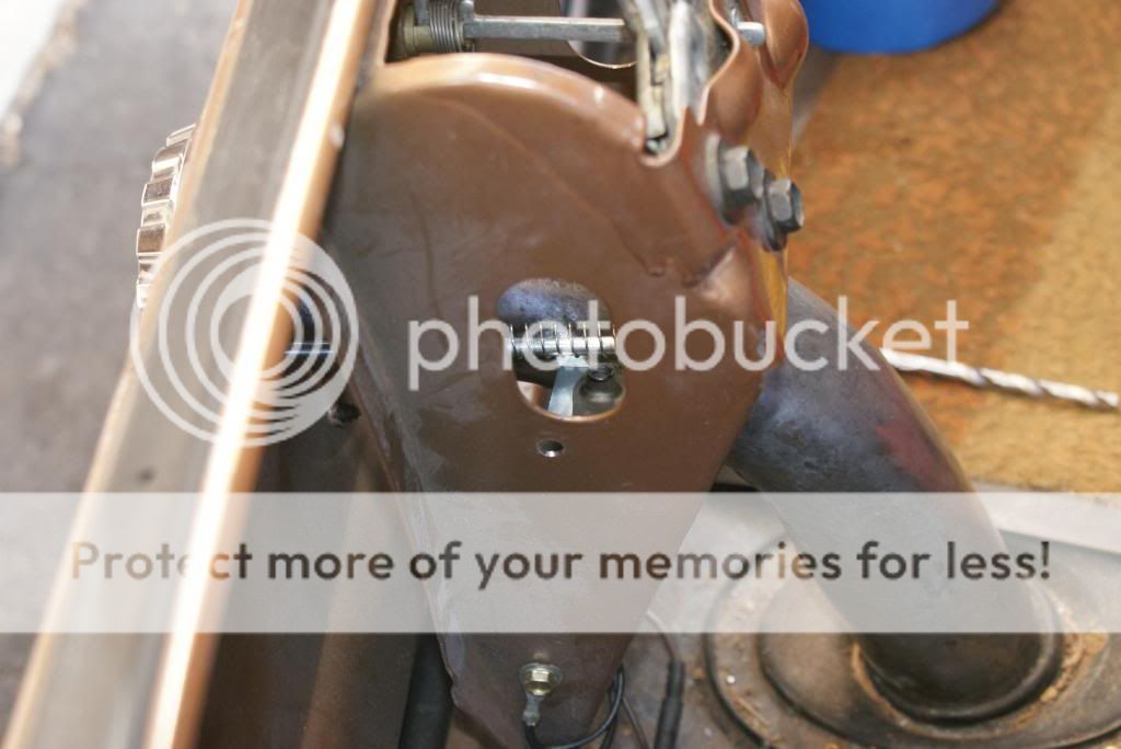

    Pix, fresh off the camera. The hardest part is my fat fingers trying to find that tiny release pin under the latch assembly.

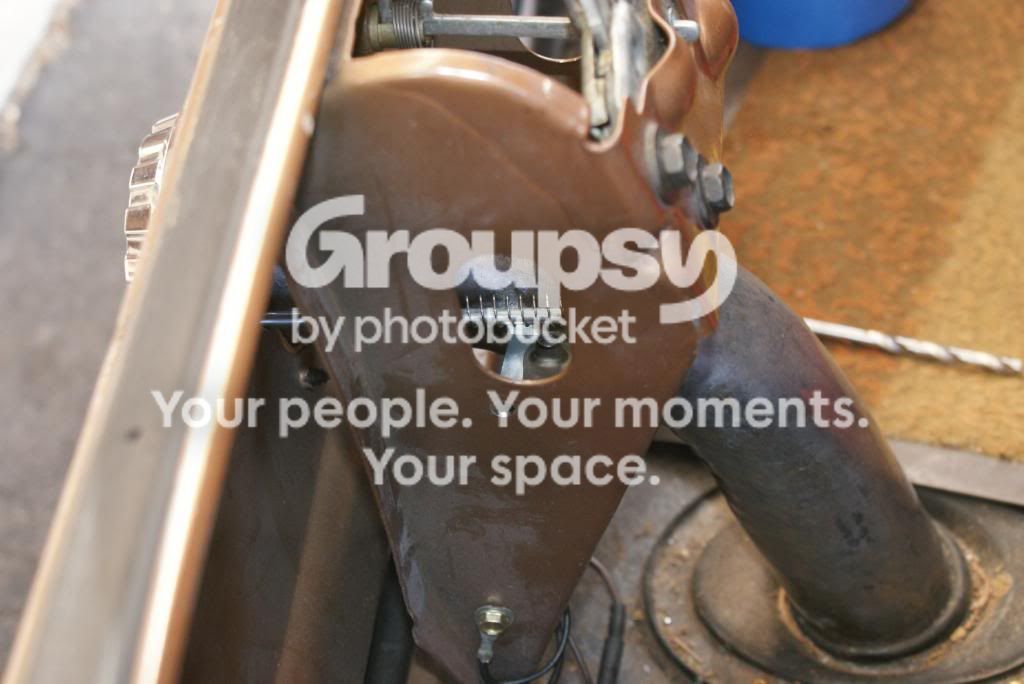

    So here’s my Scott Drake locking gas cap install.
    Remembering the kit was made for Mustang’s the parts themselves are quality (IMHO) and worth the $8 dollars. The problem is that the Ford factory brackets/braces are further apart than the Mustang. This makes the Scott Drake bracket too small for a direct fit.

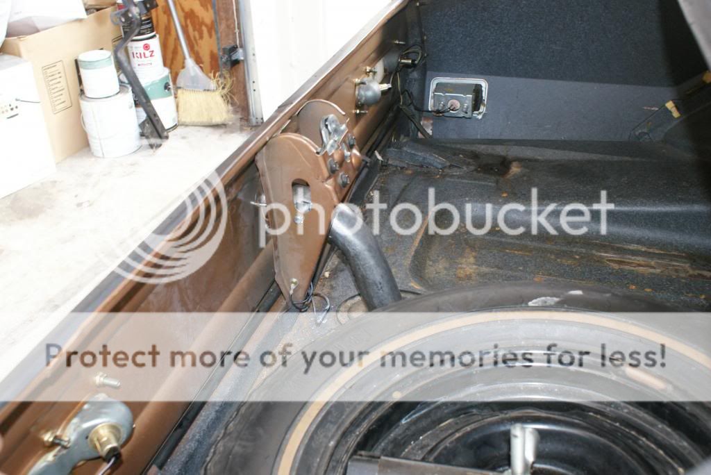

    (These are the two braces on either side of the gas filler neck.)
    There are several ways to go about fixing the issue and making it work for our Maverick/Comet’s. This is only one of many, the one I came up with.

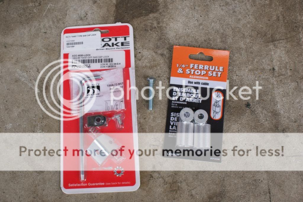

    I Largely I followed their directions, with regards to drill size etc.. I did however buy two additional parts. One ¼ inch by 1 ¼ bolt (I actually bought 1 ½ inch length because my hardware store was out of the 1 and ¼ inch bolt and I had to cut mine down). The second part was an aluminum spacer with a ¼ hole by 11/16 inch length. I had intended to buy a piece of round stock and cut it to fit but I found both parts for under $2 dollars so I took the easy way!
    The second part was a ¼ Ferrule and Stop set (for heavy wire clamping). See picture below.
    http://i325.photobucket.com/albums/k378/kboldin/Maverick/gascap/DSC04444_zps726e8e2f.jpg
    Step one, take out the following bolt.
    http://i325.photobucket.com/albums/k378/kboldin/Maverick/gascap/DSC04445_zps02e6dc69.jpg

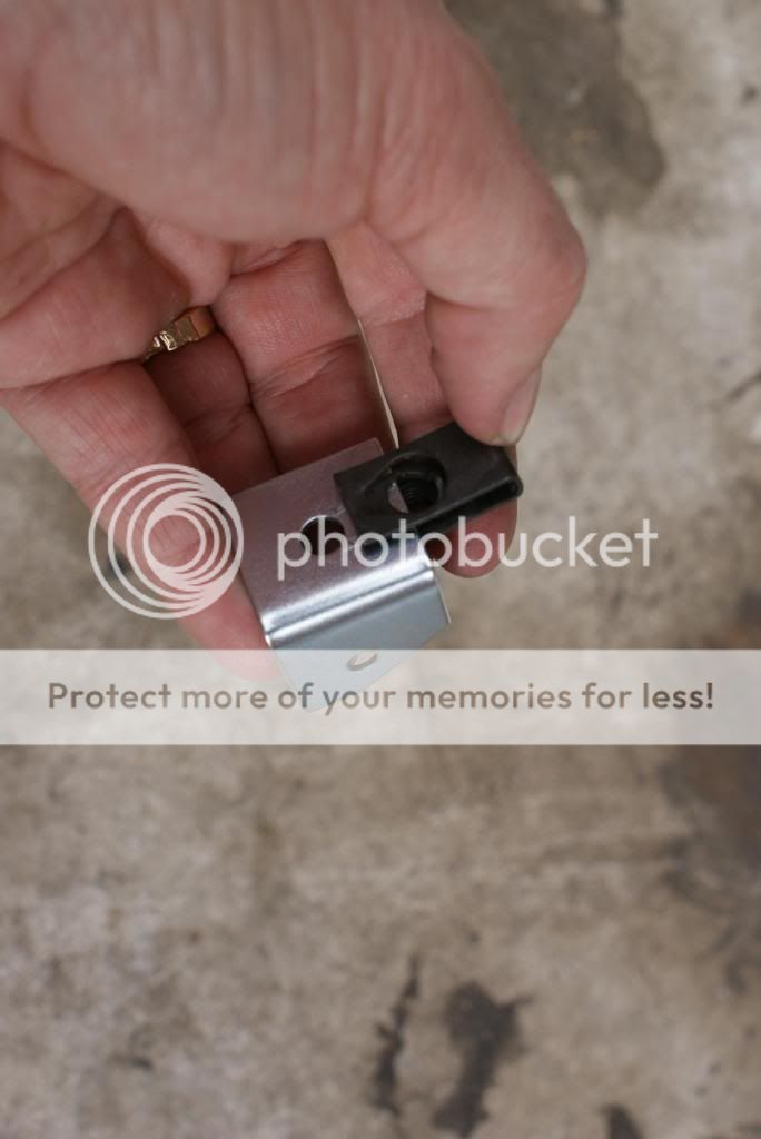

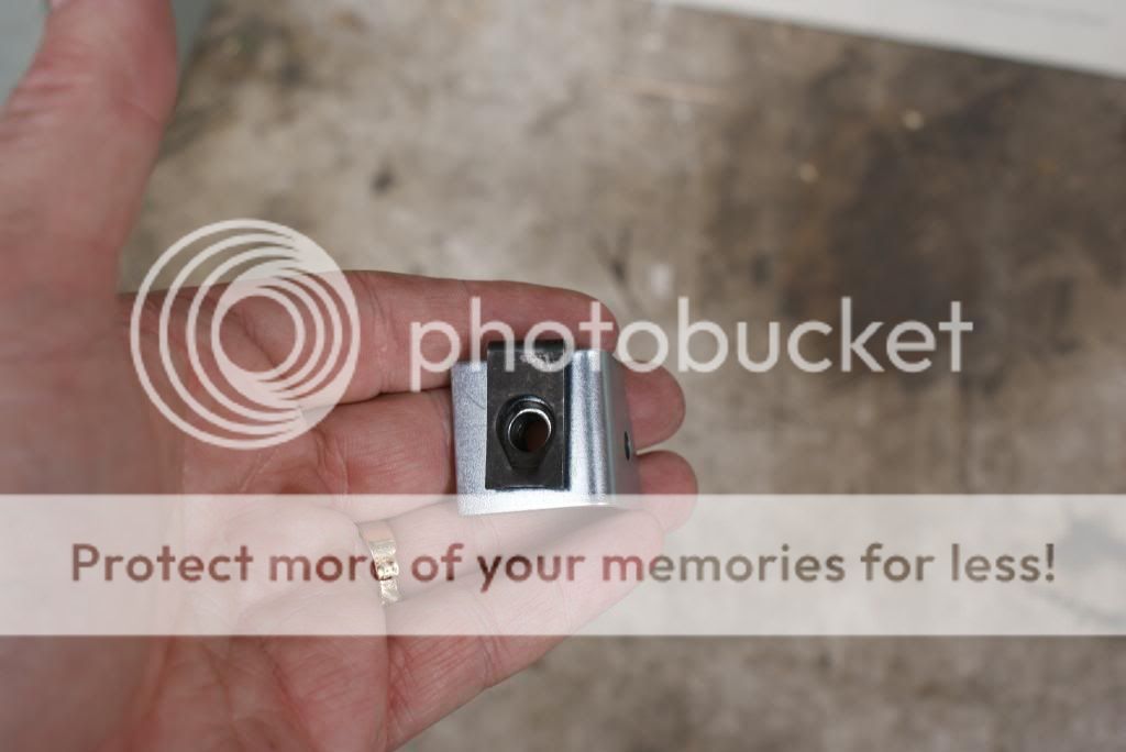

    Step two, assemble nut and bracket as shown below and set aside.
    http://i325.photobucket.com/albums/k378/kboldin/Maverick/gascap/DSC04446_zps2b0c5203.jpg
    http://i325.photobucket.com/albums/k378/kboldin/Maverick/gascap/DSC04447_zps9ee09ba1.jpg

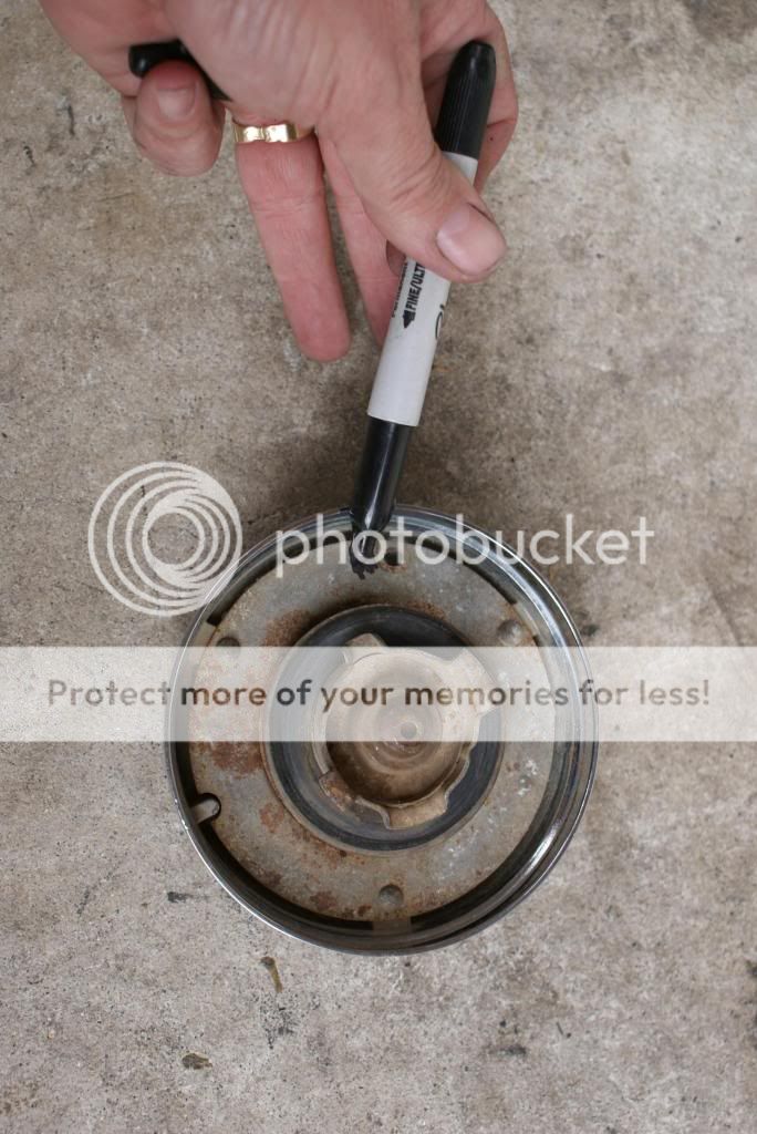

    Step three, mark back of gas cap (black felt tip pen).
    http://i325.photobucket.com/albums/k378/kboldin/Maverick/gascap/DSC04448_zps06dab1f7.jpg
    Step four, use drill bit or other marker to score the fresh ink (that’s where to drill!)
    http://i325.photobucket.com/albums/k378/kboldin/Maverick/gascap/DSC04449_zpsc0097dbe.jpg
    http://i325.photobucket.com/albums/k378/kboldin/Maverick/gascap/DSC04450_zps5e5ceb84.jpg

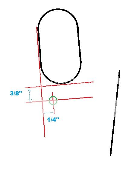

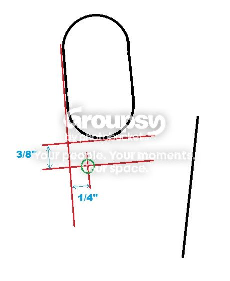

    Step five, use template below to locate the hole to be drilled.
    http://i325.photobucket.com/albums/k378/kboldin/Maverick/gascap/hole_guide_zps698a5542.jpg
    Step six, drill the hole (same size as Scott Drake instructions).

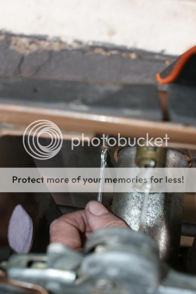

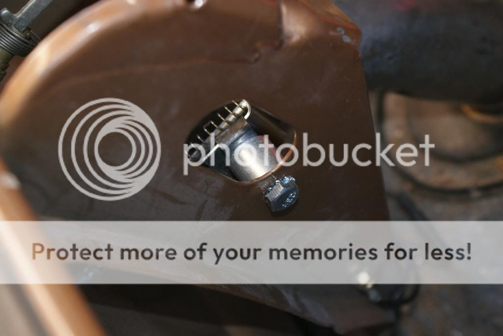

    Step seven, install gas cap and finish assembly of the Scott Drake pin, spring, cotter pin and bracket. Slide the assembly through the rear and through the new gas cap hole.
    http://i325.photobucket.com/albums/k378/kboldin/Maverick/gascap/DSC04452_zpsf675bf91.jpg

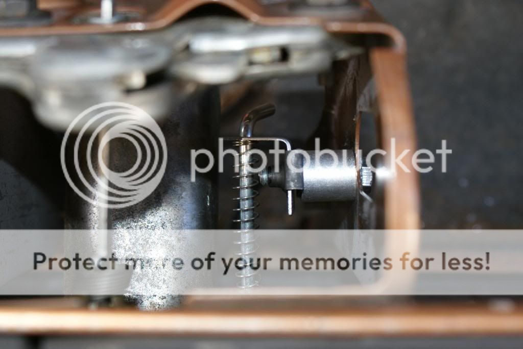

    Step eight, install bolt.
    http://i325.photobucket.com/albums/k378/kboldin/Maverick/gascap/DSC04455_zps78e426d8.jpg
    http://i325.photobucket.com/albums/k378/kboldin/Maverick/gascap/DSC04456_zpsb44b84bc.jpg
    http://i325.photobucket.com/albums/k378/kboldin/Maverick/gascap/DSC04457_zps91953da7.jpg
    http://i325.photobucket.com/albums/k378/kboldin/Maverick/gascap/DSC04458_zpsed7a5b32.jpg
    Step nine, spray a little lube on the pin and step back and smile!
    Like I said above, plenty of ways to get it done, this is just what I came up with. Hope it helps!

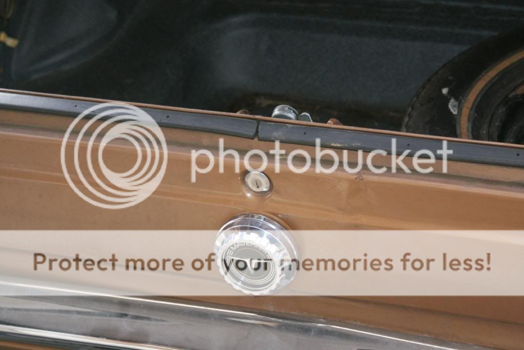

    Nice clean install, pretty subtle too.
    I nominate this for a tech article. :thumbs2:
