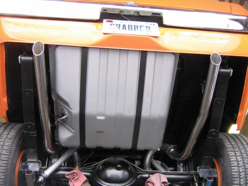

  5. maverick75
    9,017
    If you're using one of the big tanks you can still run tailpipes out the back under the valance.
    Just look up first gen camaros or the late 60s Torino/fairlane. If you route them that way you can run up to 3" pipes.
    when i get home i'll show you some pics I've saved over the years.

    Mine is 2.25" past the mufflers and runs all the way out the back with 2.5" tips. He ran it outside the leaf springs.

    I have 2-1/2" tails run between the leafs and the stock tank. Its close but any decent exhaust shop should be able to handle it. I thought I remembered seeing someone on here stuffing some modified 3" mustang tails from summit in there, but I cant recall just now who it was:hmmm:

    If you go outboard of the frame rail, as the pipes pass over the axle, and then run along the frame, the pipes line up with the tail lights (or outers on a Comet).
    I had the best exhaust guy in town tell me that he could replicate this in 2.5 inch pipe. It is currently 2 inch. The trickiest part is getting them around the shocks.
