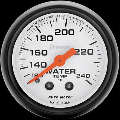

    my water temp gauge commited suicide a while ago . . . possibly homicide, not sure. Anyway, ordered this one
