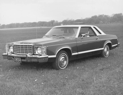

    you need stuff of a granada like this not sure what a mk1 or mk2 granada is

    Most American Ford Granada/Mercury Monarch/Lincoln Versailles front disc brake assemblies are a direct bolt on with Maverick/Comets. Ford Granada, in it's last few years (maybe around 1980 or so) where Ford switched it's Granada over to the Fox body platform with front struts. Nothing on them will work.

    No the American Granada spindles will work the european Granadas are a different platform. It would be easier for you to get an aftermarket conversion or someone from the states to ship you a set from a Granada that will work on your car.
