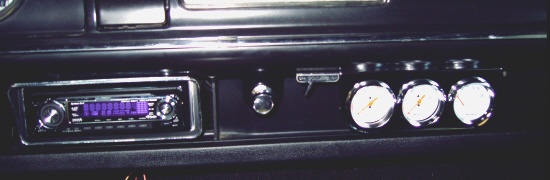

    If you have a clone no telling how it is wired. But if you have a real 71-72 Grabber, it will have this switch mounted to the bottom of the dash over near the radio.

    Grabber switch in this picture:
    As Eric (Acornridgeman) stated, this switch it only on REAL 1971-1972 Grabbers or 1972 LDO Mavericks.
