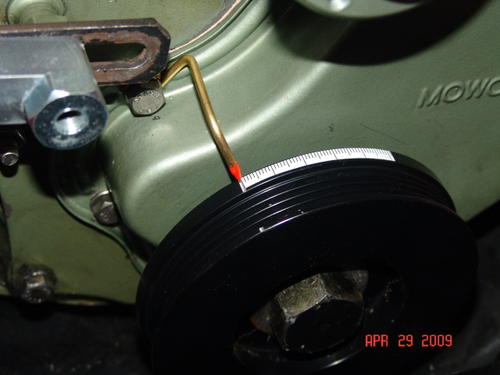

    9,014
    Next time if you're in a bind(and you know the balancer hasn't slipped)
    You can set up the engine at TDC, bolt up your pointer and apply one of those timing decal that they sell. Just put it so the pointer lines up with the TDC mark on the decal.
    I believe Mr. Gasket and MSD both make a SBF tape, just double check the balancer diameter to get the correct one.

    Those tape-on timing marks would certainly be easier for these old eyes to read. Especially down in a dark engine bay.
