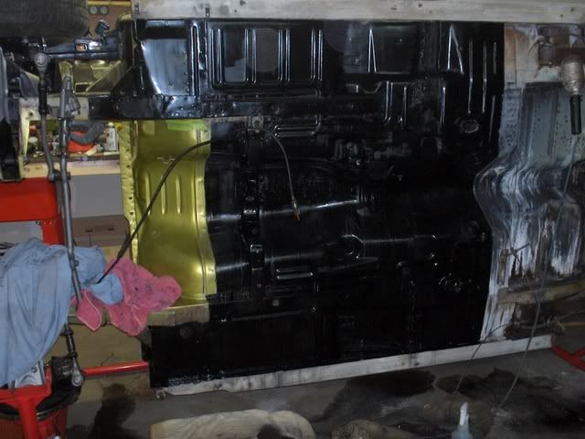

    I have it on my floor pans, inner cowl, and engine compartment/front end. I top-coated the engine compartment and front-end with Chassis Coat. Follow the directions and use the recommended cleaner and prep. The directions also state that POR-15 can be applied directly to surfaces that have been sandblasted.
