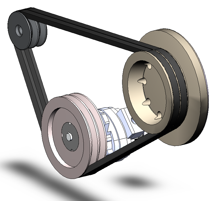

    I have a V-Belt setup like this.

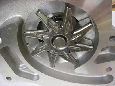

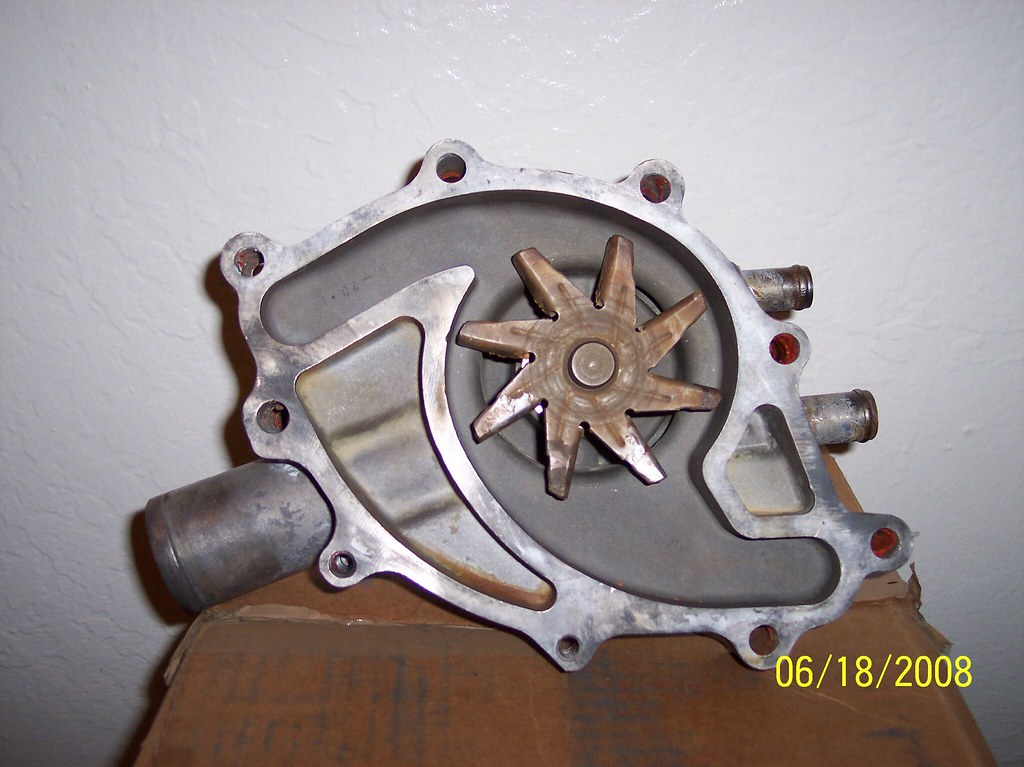

    I Checked the Water pump. It is clockwise. But I have a question. The impeller looks like this. Is it ok for a Clockwise water pump?
    Well, I thougt that it was not correct and put a impeller like this. The original impeller didn't have rust.

    So, Is the impeller correct for a clockwise water pump?

    Best way to tell is to compare it to another known pump (std or reverse rotation)
