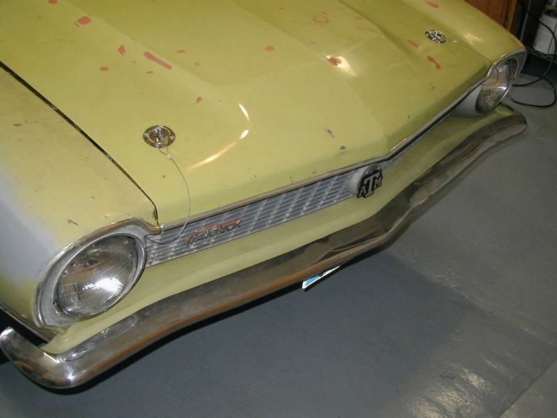

    I installed mine using the same hole in the support that the rubber bumper was in. I used a piece of rubber around the post cut to hold the hood where I wanted it. It wasn't pretty, but I was too lazy to make it look nicer (the rubber thingy).

  10. scooper77515
    I took the adjustable bumper out of the hole, installed the hood pin in the hole, and put another piece of rubber on the pin and cut and ground it until the hood sat where I wanted it to. Then adjust the pin so that when you insert the cotter pin thingy, it is held firmly. I actually adjusted mine so that I had to push down lightly on the hood to put in the cotter pin, so there was no movement or flop.
    Double-layered at this point.

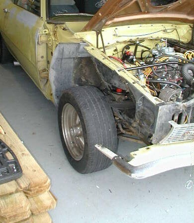

  11. adam 72
    adam 72 Member
    Nov 13, 2011
    326
    New Mexico
    1972 maverick
    It looks like things should sit hight with how high the pin posts are with the hood off
