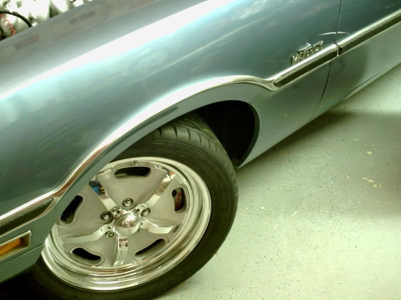

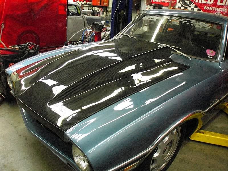

    Here's an update on the Spectre Maverick, it is really getting close to completion. The suspension was replaced with a Rod and Custom Motorsports Mustang II in the front, in the rear it features a modified Rod and Custom Motorsports Coilover Kit for a Mustang.

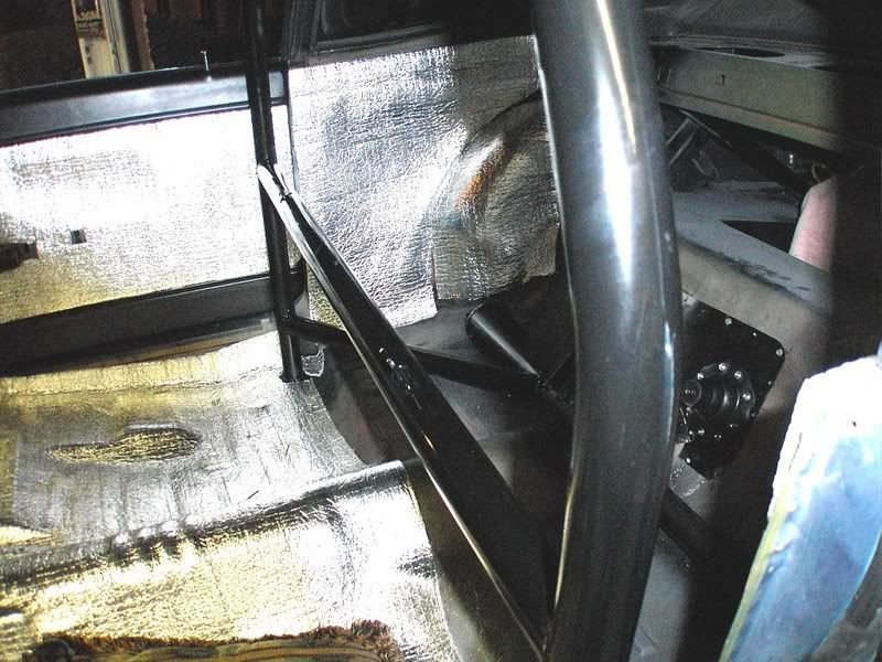

    This is the modified rear floor to accomodate the R&C Coilover Kit. The rear seat is long gone, the car will be a 2 seater and the rear will be covered with a stereo enclosure.
    The electrical side of the build has taken the longest. ECU, Fuel Injection Controller, and a boatload of Autometer Guages all had to be wired in, while keeping the Ford wiring harness to run the body.

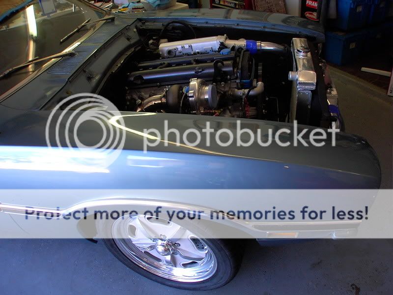

    Spectre wanted the car to be unique to showcase their new hpR Filter line. The drivetrain is a 550HP, turbocharged 2JZ-GTE Inline-6 from a 4th generation Toyota Supra, with a 5 speed and a 9" rear from JawsGear.com with 3.89:1 posi. The 5th picture below is a sketch of the aluminum intake system designed for the car. The filters will fit inside the cowl of a Carbon Fiber Hood from Maverickman.com.
    With the Coilover Kit we were able to fit a 285/40/18 in the rear, the fronts are 235/40/17's. The wheels are Boulevards by Centerline Racing Wheels.

    I see they acquired one of Maverick Mans CF hoods??Nice work on the car so far.Jury is still out on the supra engine though.It does look good in there I must admit.
    Jus call me old skool...and thanks for the pics.

    I know those engines were over built(engineered)from the get go.Had a freind with a Conquest TSI in the Navy.Man that thing would go!!! I am sure the Mav will too with that screamer in it sporting a hair dryer!!!(y)
