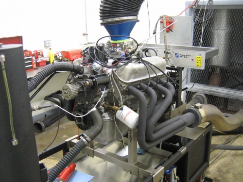

    As soon as my motor was built......it was slapped on an engine dyno, broke in for about 20 minutes (to set the rings.....cam and lifters was a roller).....and then all hell was broke loose as they reved the dickens out of it!!

    I am pretty sure they fired the motor up...let it run for about 20 minutes at about 3500 rpm (I am guessing). Changed the oil and filter, fired it up again, got it up to temp......then started reving the crap out of it. I was there a few days later and they fired it up for me on the dyno and revved the pi$$ out of it some more. Pretty darn loud I can tell you.
