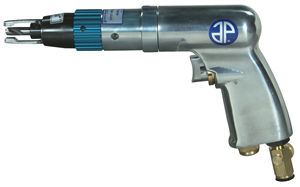

    Here is a neat air tool that I would consider buying. I never used one of these but it sure looks like it would make short work of the welds.
    Here is the web site:
    http://www.drivewerks.com/catalog/shopcart/TOOL/POR_TOOL_CAT324_pg2.htm
    :thumbs2:
