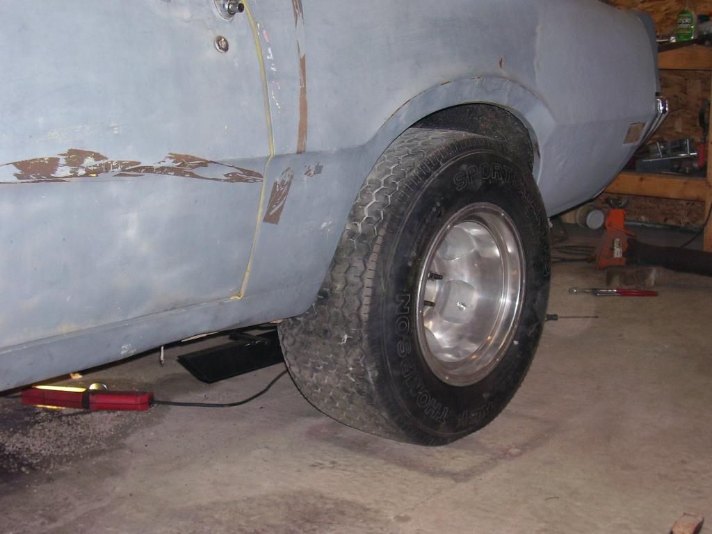

    I too like the looks of the Lakewoods. These were chrome when I bought them some 20 years or so ago..
    Notice the tube us not square. It's more like 1 x 2.

    Thanks for the photo Gene...I've never owned a pair...so I might have to fabricate up a wider pair, for the Caltracs Bar to fit into.

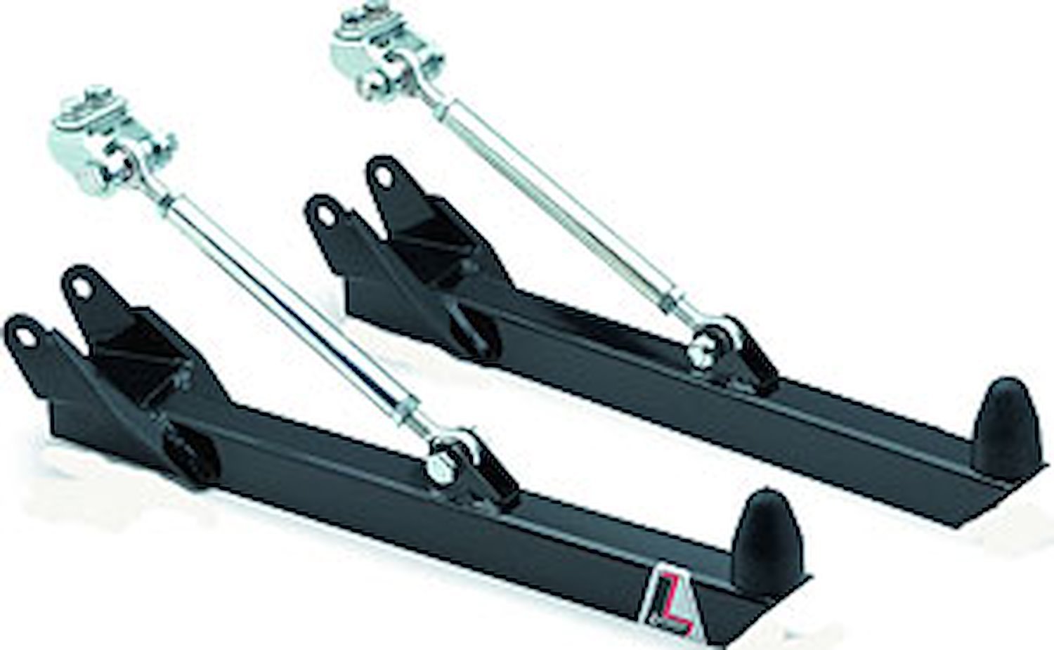

    You could take the correct size rectangular tubing and cut it so it is essentially angle iron. Then you could weld a u-bolt to it that would fit around the caltrac bar and clamp it on. keep the hardware to the inside and from the outside they would look like the Lakewoods.
    Craig, here is a picture of them, couldn't find a good one of them installed. A guy I went to school with had them on a 71 Monte.
    Found a decent one.
