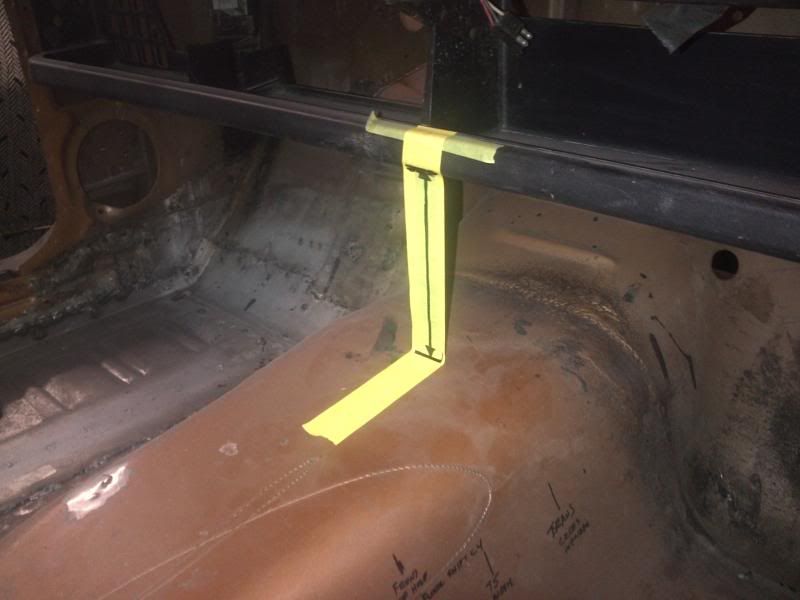

  14. Dave B
    I posted some pic's in my Project thread, and on Facebook.
