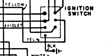

    So all my idiot lights work exept the brakes light. I've read That it is supposed to light up like the temp light when cranking the engine. It doesnt. I grounded the wire at the switch With the brake lines and it comes on. So bulb is working. Where do i look for the wire That is making it light up when cranking the engine. Been Reading up and down on the forum but Cant find anything about That light.. this light is critical That it works when i show the car to get license plates.

    Brake light illuminates IF there is a 225 PSI differential in front vs rear pressure(moves switch off center completing ground circuit)... Amount of fluid has zero to do with illumination...
    Also lights when cranking via a ground contact from black wire in ign switch to Violet wire...
    If it lights by grounding violet wire(which is same point as on pressure switch), either ground to ign switch or switch itself is defective

    The temp light ground from switch when cranking is red/white wire directly to right of violet wire... I didn't snip enough to show color...
    Since brake light lit when grounded under hood, I'll bet the ign sw has a internal issue... May be poor connection on switch connector...
