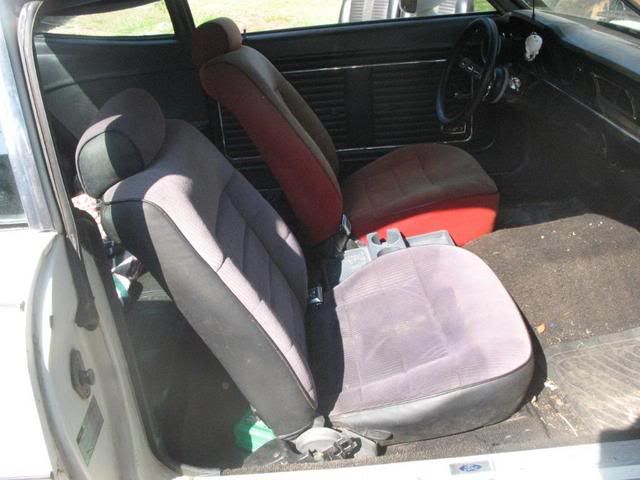

    They are in and they look great. They are both passenger seats...but I will survive. One red and one dark blue. One cloth back, one vinyl back. I actually got three seats and used parts from all three plus the bench to get it to work. Ill recover them soon enough.
    I used the tracks from the bench seat on the outside and the Mustang tracks on the inside. I got it all to work fine and it's great. They track fine and adjust properly.
    I noticed that they are a little cock-eyed so I will need to shim the outer tracks a little.
    Did I mention I love them?
    Well I do.

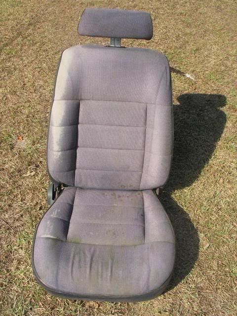

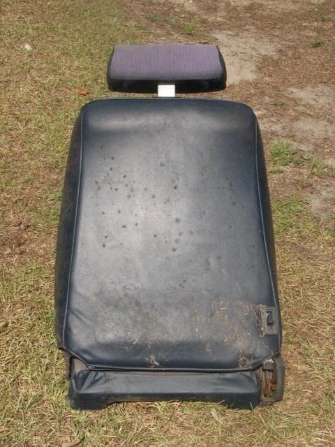

    The tracks on all three were different. One had a wire control to make the sides work together, one was springloaded and one was a mix of the two with a small wire and a spring on both sides. I used the tracks from the Comets bench and rigged the Mustang tracks to work with them. I used a small chain with S-hooks to connect them together so they tracked and locked properly. It took about 2 hours in the 100o NC heat and the help of my 9 year old daughter(couldn't have done it without her help!).
    She got the first ride.
    Installed.
    Unused seat back.
    Unused seat front.
