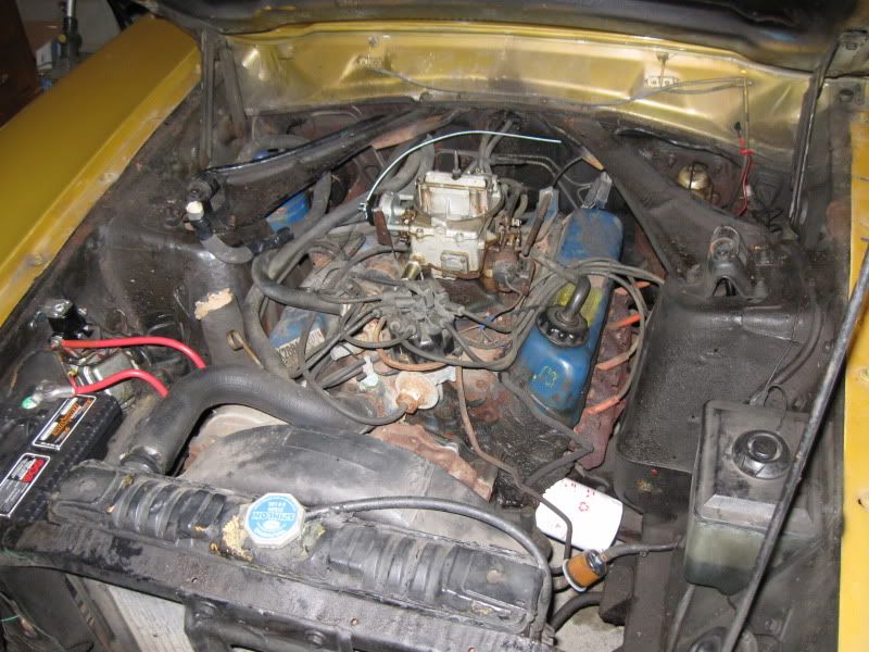

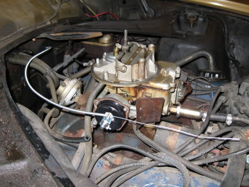

    I'm near Woodstock... took some pictures, mind you she needs lots of tlc right now and I'm slowly learning things... oh and that's not how I'm going to leave that choke cable ! :D

    I got a stud and replaced one intake bolt with it. That works well. I think there is also a threaded hole in the vacinity you can use too. I am not on my own puter so I can't come up with a pic
  7. Dave B
    Years ago, I had one mounted to one of the intake bolts. Like Bob said.
    Wouldn't have been just as easy to fix the electric choke?
    Nice car, I've wondered about that one in Sarnia, just never bothered to go see it.

    Can someone identify my carb number and type (I cannot locate the tag but it looks like it's a Model 2100-D 2-V according to my shop manual), I'll look into an electric choke, it will certainly look nicer.
