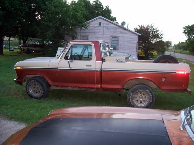

    Yesterday morning I replaced the starter on my truck because the recoil spring wasn't pulling the starter drive away from the flywheel very quickly.
    That evening I purchased a three gauge cluster to put in the maverick while on a regular 80 mile round trip to the city. Just as I was pulling into town, the maverick's oil pressure light flickered when the engine went to idle at a stop sign. It did it again in the driveway.
    It's always somethig....
    ( May have something to do with driving a couple of 30+ y.o. vehicles)
