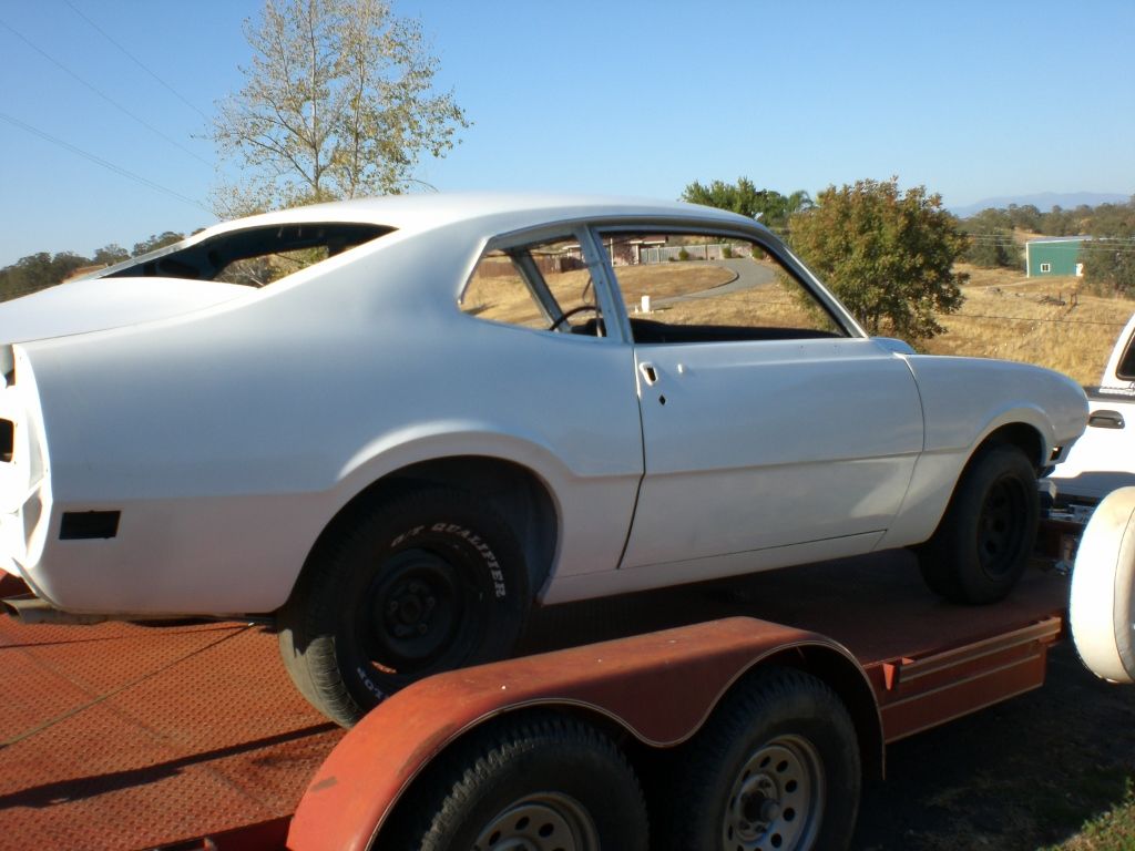

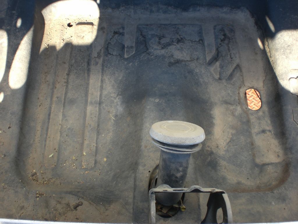

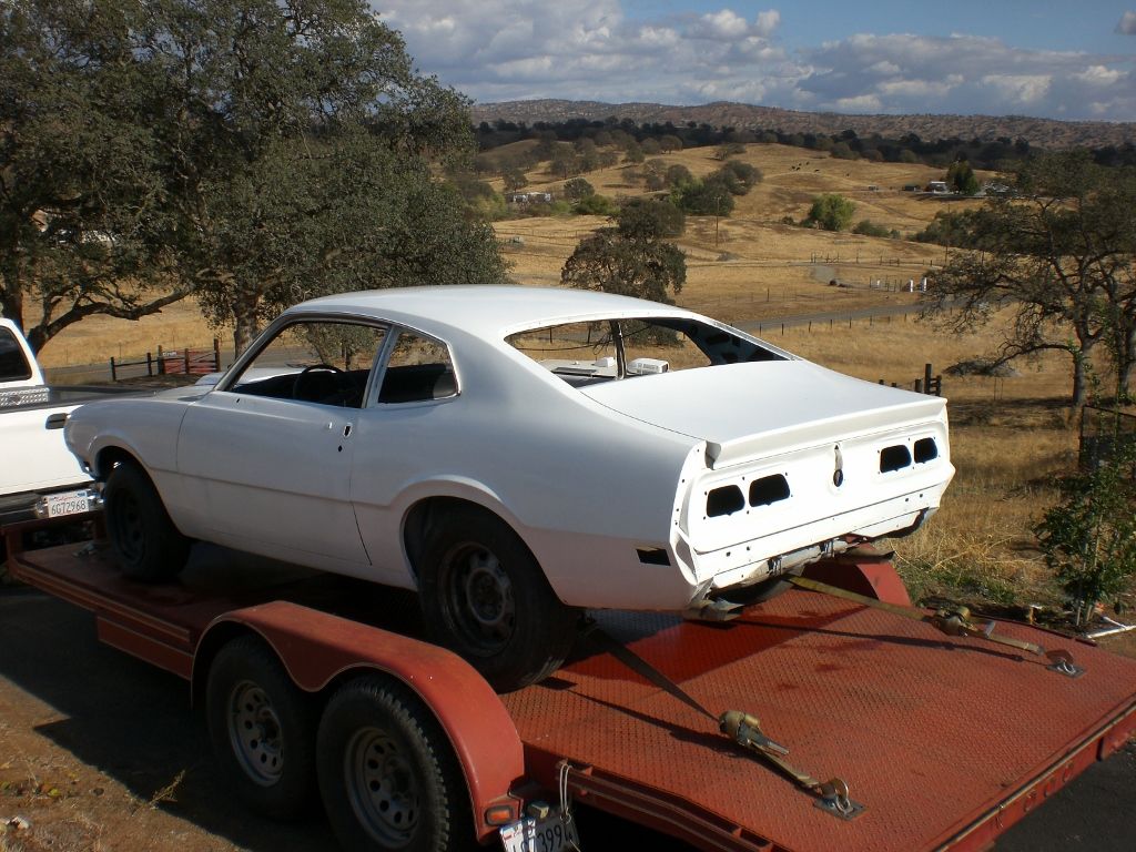

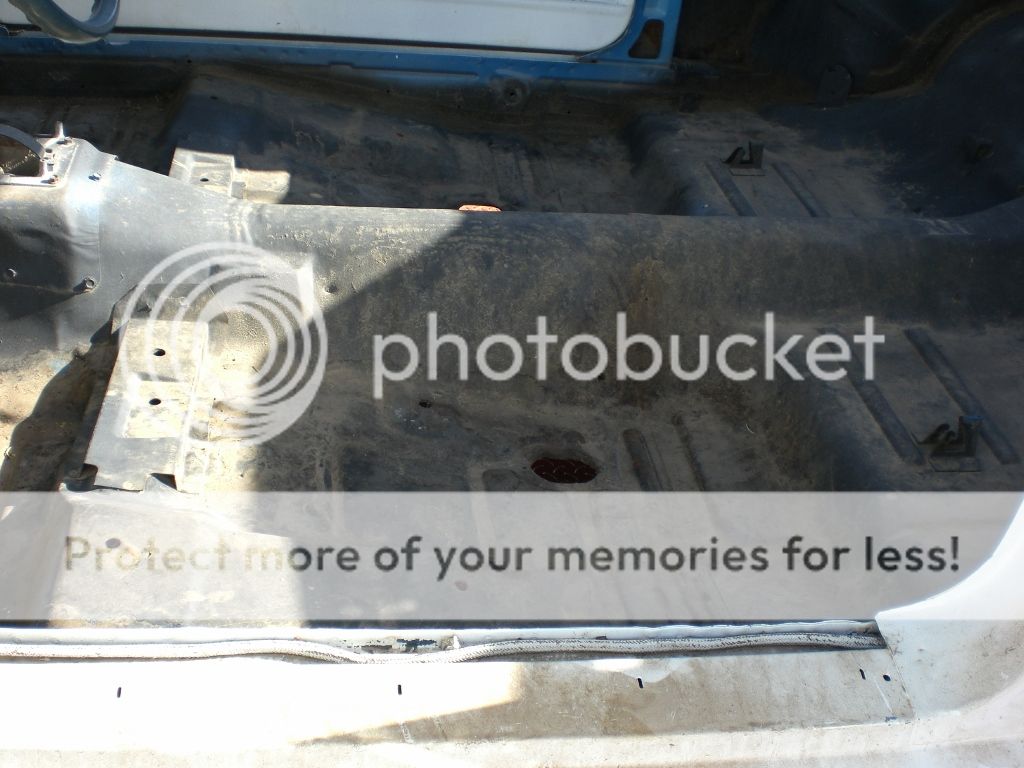

    picture time
  6. mav1970
    Wow! Really great starting point for a nice build. Is the photo of the car on the trailer the way you got it?

    Factory Floor shift as well as a factory bucket seat car.....cool.
  8. Dave B
    Nice solid car.

    i wish i had been able to start with a solid base like this... awesome!

    thats exactly how I got it. I still have to put door handles in and all of the glass oh and the PERFECT grill
