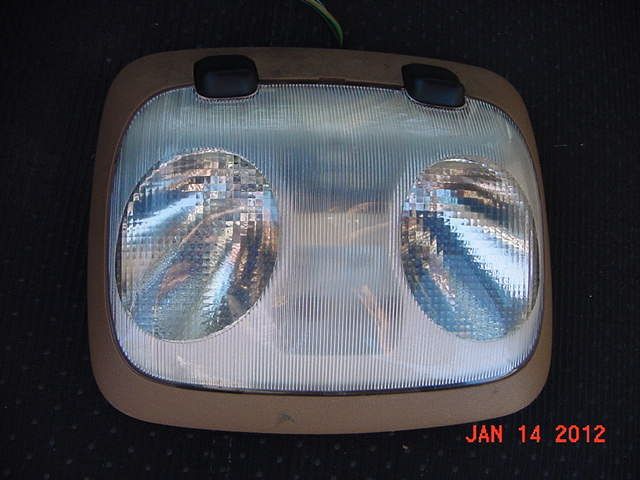

    Pretty similar to the light, just a different bulb and this one comes with a gasket and the chrome looks great on it. It's an eBay deal, I think it was $15 or 20 for the dome light. The wiring is pretty much what I need but might be hard to find. I can make my own if need be. Thanks

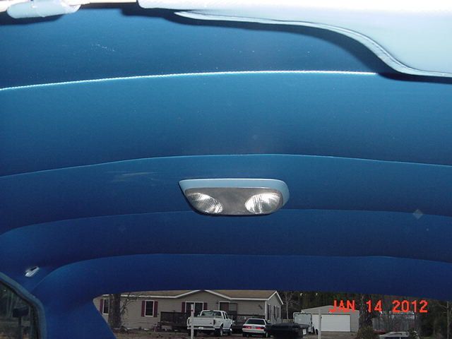

    Not a deluxe dome light but a huge improvement over what I had and cheap from the local Pick N Pull.....[​IMG]
