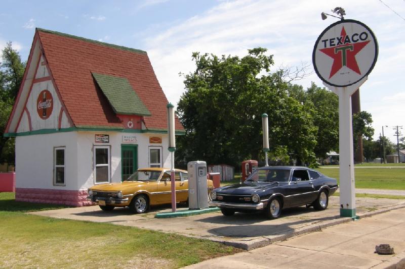

    Here's a recent picture. The '73 on the left has the Mustang springs. The '71 on the right is all stock.

    what was the a reason for the 1" spacer?

    Because I didn't want it any lower than how it is in the picture and I knew if I didn't use it, it would be too low. I knew this because I test fit the springs before ordering the spacer.
    If I had the standard height 65-66 springs, I wouldn't have used the 1" spacer.

    Ok,i just make'n sure it wasn't needed to make em fit lol,sweet now those are added to my wish list....
