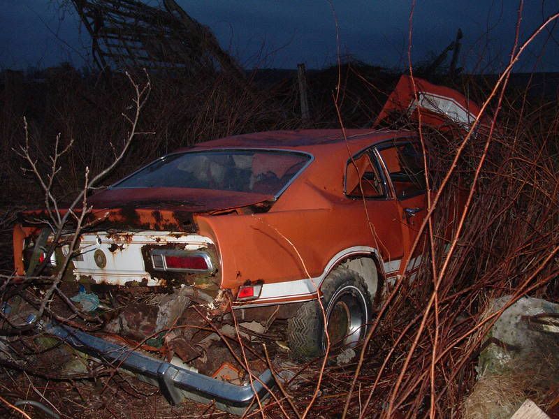

    That's not "major" rust....:rofl2:
    This car has major rust.....
  7. 464925
    Jan 18, 2010
    48
    In my Mav.
    Maverick 1973-Pure Muscle.
    :rofl2::rofl2::rofl2::rofl2::rofl2:
  8. ESampson
    ESampson Member
    Dec 20, 2010
    1,453
    Nanaimo, BC
    1974 Comet GT
    Lol the stupidest part is...i'd still trailer that car home for parts.
  9. Racer_X
    Racer_X Maverick Hugger
    Nov 8, 2007
    1,191
    North Carolina
    1974 Maverick (1970 clone)
    :biglaugh::biglaugh::biglaugh::biglaugh::biglaugh:too major
