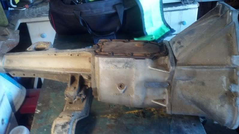

    need help to ID this manual trans....
    Case#rf-098r-7006-ab
    c-26044194
    Tag# RUG EM KB10
    E2ZR AA 0137
    I have found very little info on this trans...any help would be great..:hmmm:
  2. rthomas771
    8,075
    963
    '82 is the year...3-speed with overdrive

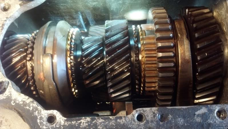

    this is a pic of the top gearset...to me it looks like that it has too many gears to be a 3 speed OD...I dont have the shifter to run the pattern...:huh:
  4. rthomas771
    8,075
    963
    I see 4-foward gears and a reverse gear

    is this the T 176? I was told this was a 5speed...I got it for free so the expense is little...which gears are the forward gears...forgive my lack of knowledge..
  6. super sonic mav
    super sonic mav Member
    Mar 5, 2009
    260
    50
    Zimmerman,Mn.
    1976 Maverick Stallion
    OK....I was able to run thru the gears....4 forward one reverse....I know very little about manual trannys...is this a good trans....can it be used behind a v8? what would it have been in? is it like the manual version of a c4?I have a 4:10 gears set in the stallion now..have a 3:89 gear set on the shelf...lots of questions I know...have been searching the net...not a lot of info out there...looking to you folks for help...
  7. rthomas771
    8,075
    963
    Does the other side look like this? If so it's a Srod 4-speed. The T176 shifter is part of the top cover.

    That's it....

    That was a good read...the tranny would behind a mild..very mild 302...read good things and bad...would like to know the gear ratio's though....
  10. mav6977
    mav6977 Member
    Sep 3, 2002
    186
    60
    Wichita Falls TX
    various years
    Thats a SROD from a 82 Mustang. Gear ratios are 1st:3.07 2nd:1.72 4th:.70 and reverse:3.07. 3rd is of course 1:1.
