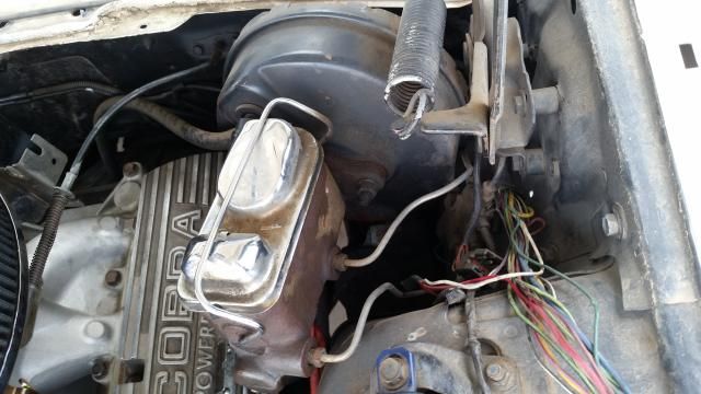

    Hey Fellas, I think my master is on its way out.. and at the same time pondering the idea of swapping the car over to manual brakes.. Which from my understanding takes a bit more than just removing the booster... and speaking of which does this look stock for a 76 disc front rear drum car? I've never see the master and booster sit at an angle like that.. the lines from the master look home made also.. maybe just to replace the OEM ones??

    Looks stock to me...

    Looks like the factory power brake booster.
    You will need to change out your brake pedal and pedal support if you go manual.

    Me neither. That was one of the first things I changed in my 77, power brakes to manual. To the OP, you'll need a manual pedal support to do this or modify the power support to change the axis of the pedal pin to where it's parallel to the ground. You'll need a manual brake master cylinder too and reroute a couple of the brake lines from the proportioning block to the master. The pedal effort is not something difficult to live with, not bad at all. The room created in the engine bay is the biggest plus. That was the primary reason I converted my car's setup.

    You have to change the pedal support as well. The power support has a different axis for the pedal rod to match the tilted master cylinder.
