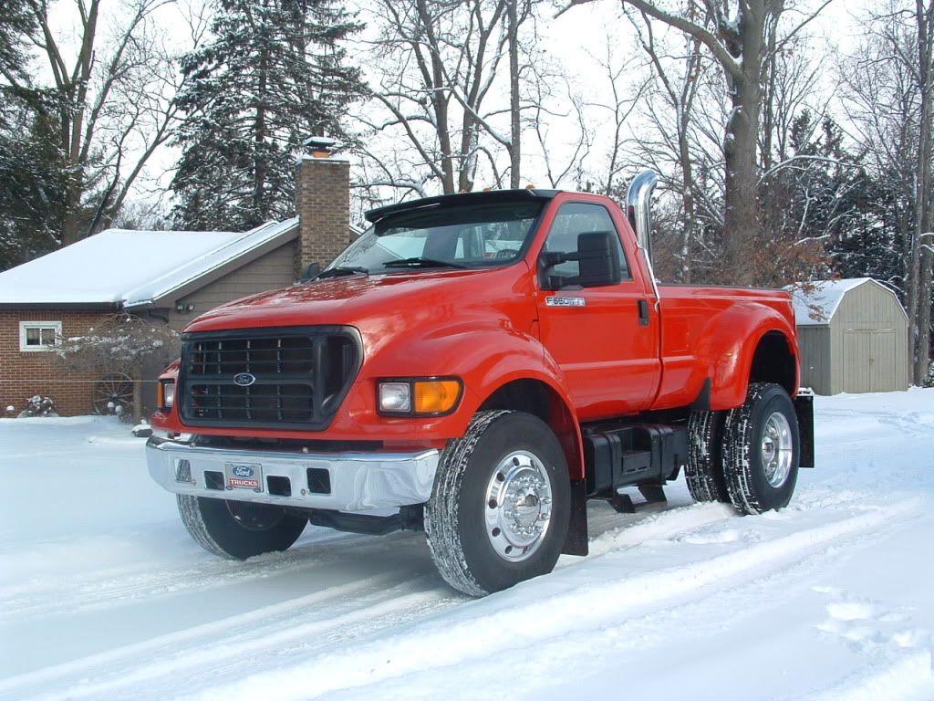

    You would probably be more comfortable in something with a little bit more headroom. Like a pick up truck.:eek:
