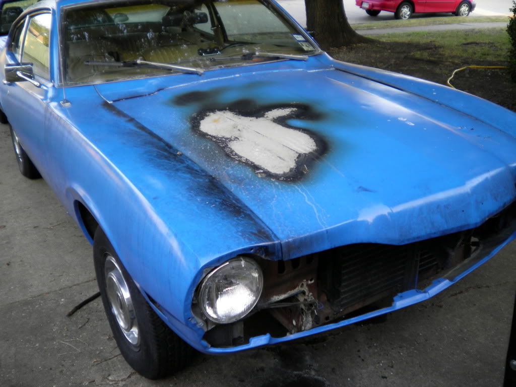

    Yesterday I was at school, and during first period I got called down to the office. They told me that my car had caught on fire, and that the fire department was there. They took me out there to see it and to open the doors to release the carbon monoxide. What I found was what I thought were the charred remains of my car. [​IMG]

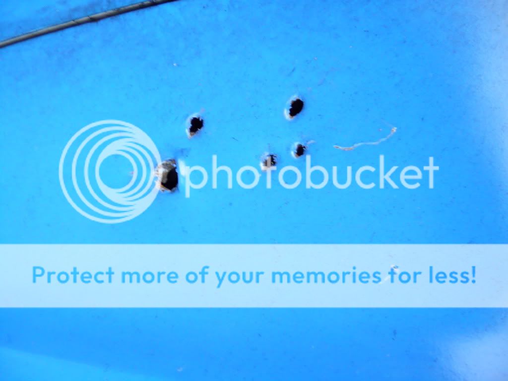

    They told me that it was most likely the wiring that caused it to catch fire. They also told me that they had to pry open the hood. [​IMG]
    With some closer inspection, I found that it was only the battery, wires, hoses, and belts on the left side that were burned. The right side was virtually untouched, and the interior was completely intact. Luckily there was a security guard in the area that saw it or this might be a complete loss. Basically I have to completely rewire and replace the hoses on the left side, but I have a couple questions:

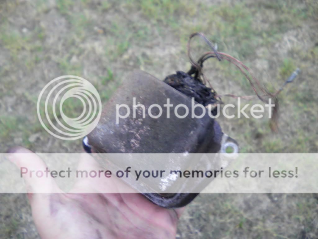

    1. What is this? It was on the left side near the battery. [​IMG]

  2. Mavaholic
    14,992
    209
    Its the voltage regulator.

  4. don graham
    Sorry to hear that. Hope you find everything to replace the wireing. The voltage regulator can be picked up at any parts store.

    Just so you know, the battery and that regulator is on the right side of the car.

    Why did they have to "pry" the hood?

  7. maverick75
    9,014
    Thats how my Maverick is ;) and it was a pinto one as you need a front pump pan.
