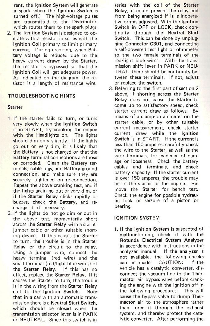

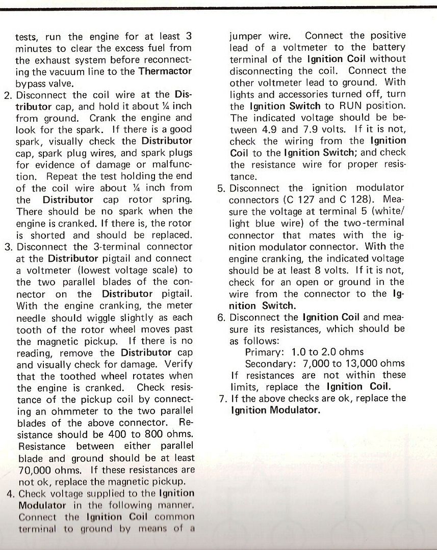

    In the 1976 electrical Trouble Shooting Manual it states the system will produce a spark when switched off after cranking... I suspect that a good sign the module and wiring are OK, I'm betting the pickup inside dist... Make special note of #3 on page two..
    Here's the test procedure, note the manual is calling the ign module the modulator(even Ford has flub ups)...
