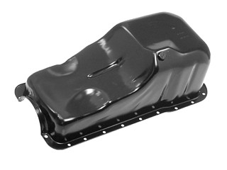

  5. Dave B
    You need one like this, the sump is at the front

  10. Dave B
    No...I'm wrong. I just looked at a picture of mine....it's been a long day :)
