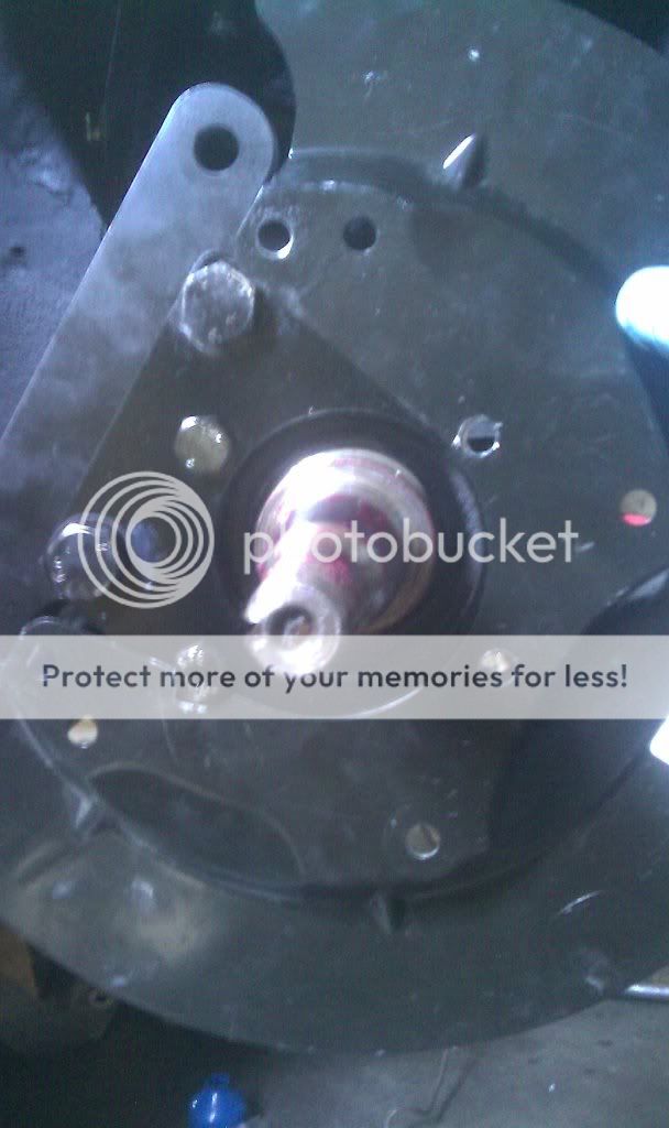

    First the link for the kit http://www.mustangsteve.com/cobrabrakes.html
    I lucked out and grabbed low milage rotors,calipers,pads, backplates, hoses from a 07 mustang for 14$ plus shipping. If you can grab the calipers and backplates for cheap this is a great mod and probably best bang for the buck..

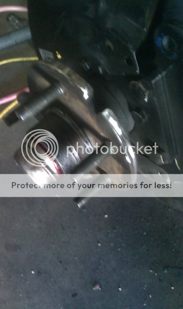

    First remove the old drum setup, so only the spindle remains. You'll need to press out the old drum hub and install explorer 02 rear disc studs into the hub. TRUST me the studs will save time in the long run. With just the spindle on mount up the kit. Its pretty straight forward.
    Next place the back plate up how you want it.. Mark for holes to be drilled. Before drilling the holes place both plates back to back. This will allow you to drill both sides in one shot.
    Next if the rotor will not sit flush against the hub you'll need to grind the outer rim down. Trust 4.5 grinder did the task in about 5mins for both sides. (TRY TO KEEP IT EVEN!)
    You can run new lines or use an adapter line that allows for bubble and inverted ends. I went the long way and install new lines. I ran the hose under/behind the spindle towards the front of the car. Drill/tap and mounted the flex line then looped the brake line in. Looks GREAT!.. The line moves freely through all travel.
    Thats it for now, I'll have pics of the rotors and pads in place when I have the front tires of again. Suggestion? or Questions?
