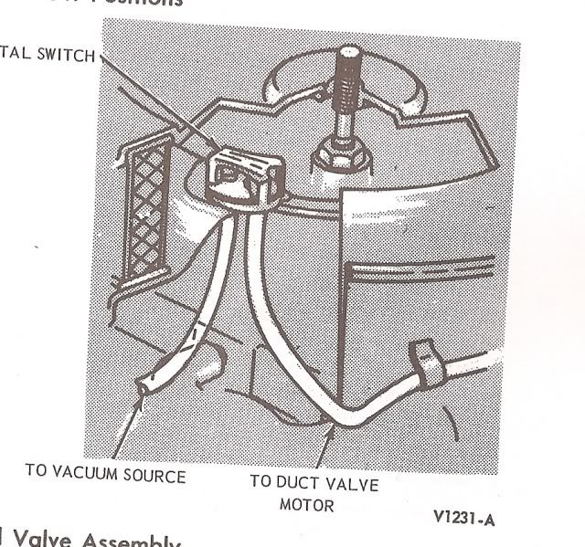

Before you fire off any suggestions please note that my knowledge of cars is very limited, though I am very eager to learn how to make my car purr.... I've just had the car serviced (new distributor, point, and fuel pump) as a result the car ran great for about a week. I go to use it the other day and the car will not stay running. As soon as I shift into gear it putters and shuts off. messing around tonight I found that if the line on the left in the picture below (to vacuum source) is disconnected from the air breather the car will idle smooth and there is no issue shifting into gear. I know it activates the duct in the neck of the air cleaner but it appears that it does not matter if the duct is open or closed only if that line is connected to the breather. If the line is allowed to blow air freely the car runs much better. Do I need this vacuum line connected to anything? What can I do to solve my idle issue?

Answer to #1: The vaccum line is not "absolutely" necessary as long as your carb is getting good air flow from snout or heat exchanger. #2: Areas for a quick look and hopefully quick fix: You might check all your vacuum lines or vacuum "caps" to (or on) the new distributor and make sure one hasn't come loose. I've also found these old cars need to be started properly and warm up good before they'll run smoothly. After you've done that get some carb cleaner and use it to clean the air cleaner duct valve (in the snout), the temperature sensor (shown in your pic) and the carb itself. Didn't happen to "wash" the engine bay did you? If so, water can wreak havoc on the ignition system and cause symptoms like you've described. If water is suspected, remove distributor cap and let it dry completely. Use compressed air if available to speed things up. Make sure all spark plug caps are on good and tight.

Seeing is how you are in Canada,you really should have the vacuum line connected. This system draws hot air from the exhaust manifold and keeps your carb from "icing" up. You only really need it when the outside temps go below 40°f,or so. As was said before,check your choke setting and make sure it opens fully when the engine is warmed up. If your problem started with a cool down where you live,the choke would be a good suspect.

A manual choke requires you to push the throttle to the floor before engageing the choke. It also requires you to push the the choke off once the car has warmed enough to run on its own...You may be correct and it may be operator error or it may be debris in carb that flushed itself loose and now all is right with the world. Cold air requires alot more fuel on start up in order the get adequate fuel vapor to fire off the engine. Hence the need for the choke. I would leave the carb heat set up in working order if you intend to drive the car in cold weather. Its function as stated is to prevent carburetor iceing by warming the incoming air. Dont leave vacuum lines open allowing a vacuum leak. Its not good for the engines valves or fuel economy/consumption. Good luck!!!
