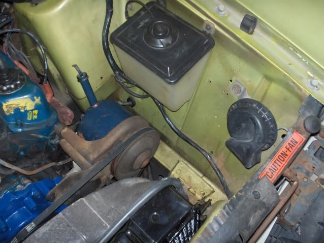

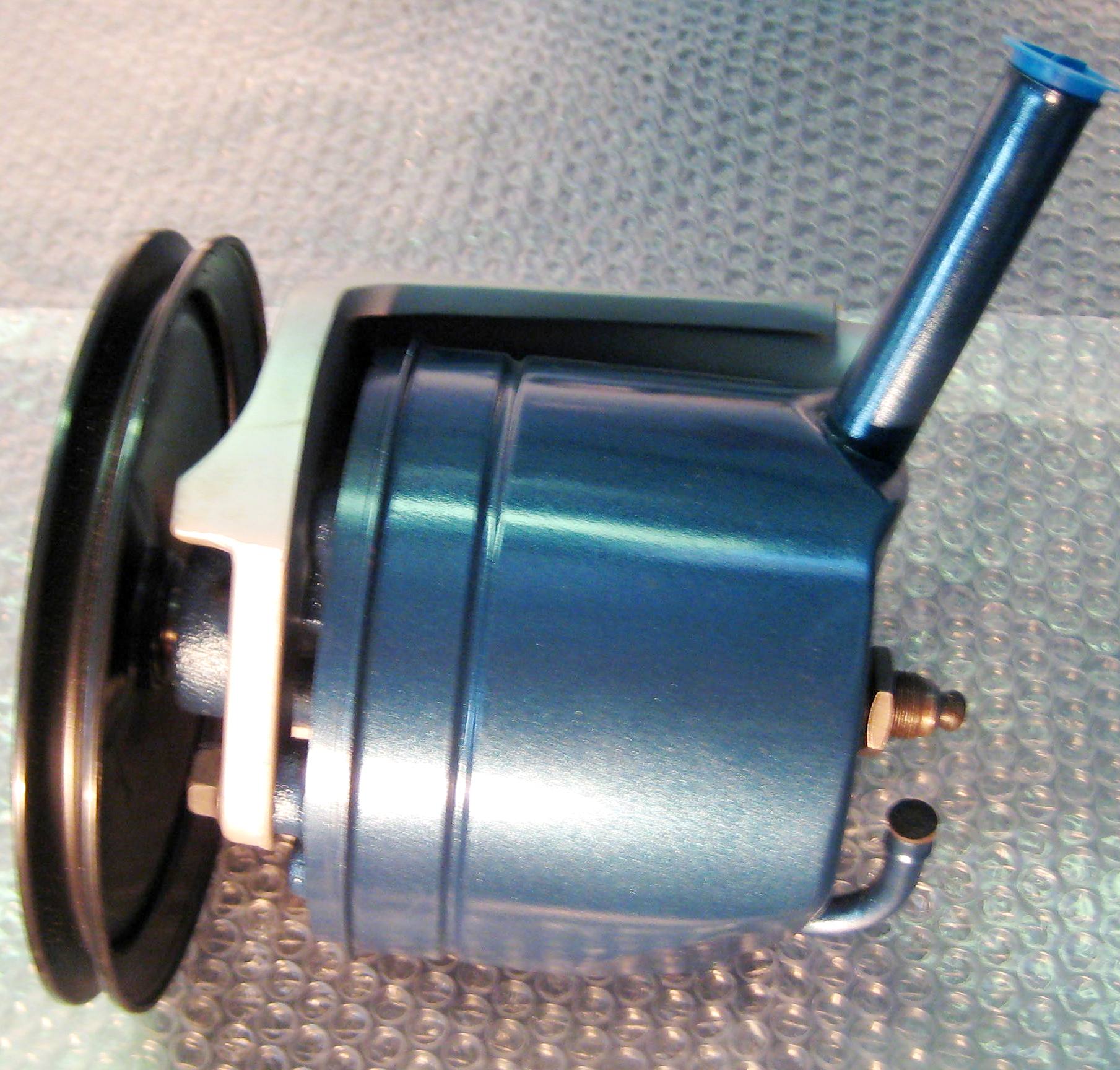

    tore down for major cleaning and fresh paint. do you think it looks best painted same as block? or....maybe some of you have done something different? if so, share a picture?

  2. Dave B
    They came a different shade of blue. NPD use to sell the correct paint.

  4. Dave B
    Duplicolor GM258 (this is a spray can), is close. I also found one that is a Chrysler color, I'll have to find the number. It's a blue-ish teal color.

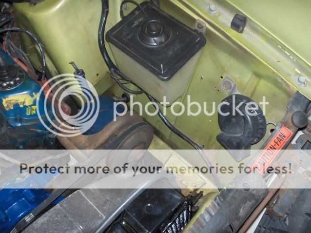

  7. Dave B
    I wish I could have found a bigger picture....:biglaugh:
    Here's what mine looked like in my car, when I bought it:

  8. 71nogo
    71nogo Member
    Mar 24, 2010
    1,572
    tucson,az.
    71 grabber
    thats what color mine is dead on! i was thinking of going a different color, but i did like the way that BIG one looked:rofl2:.
