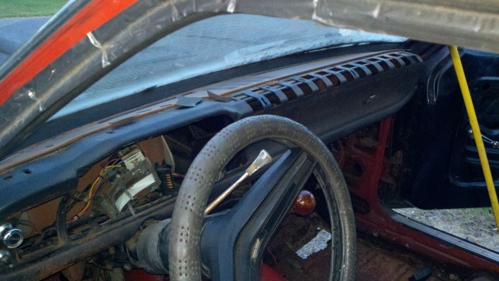

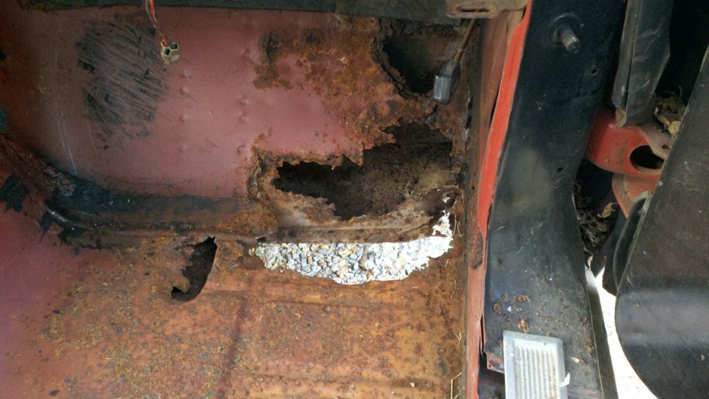

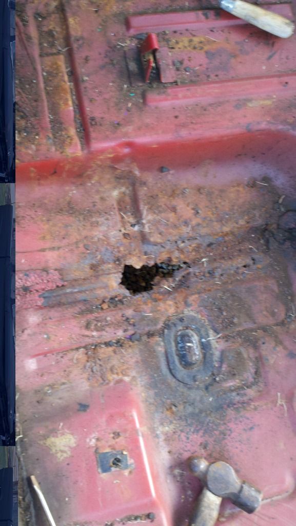

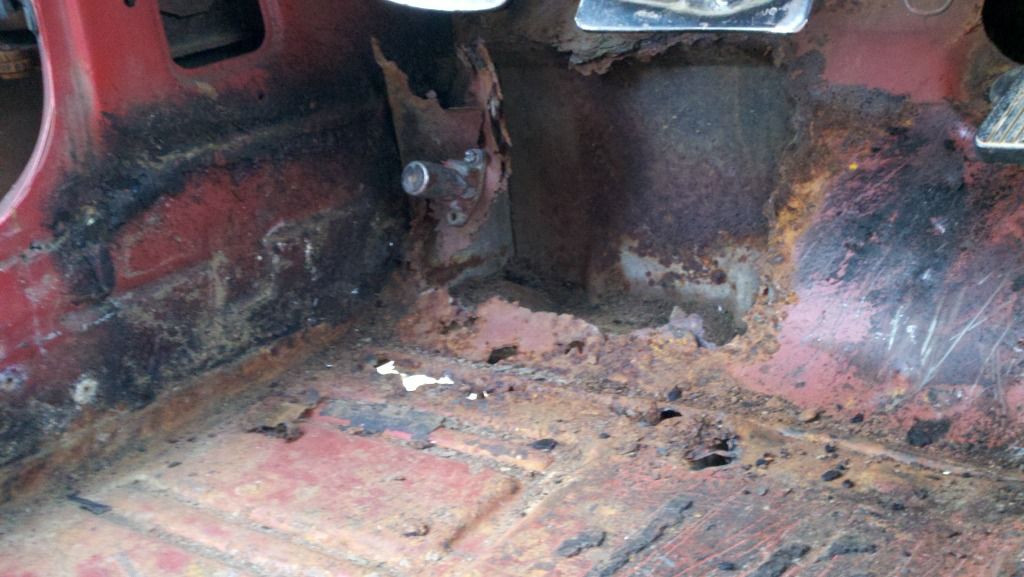

    Few pictures after I stripped the interior for the rebuild :)
  2. mav1970
    Looks like you have a lot of welding work ahead of you. Been there and done that LOL! Just so you know, reproduction Mustang floor panels can be made to work and they are cheap.
    Good luck with your build - I'll be watching your progress :tiphat:

    I've got a parts maverick that so far the floor pan looks immaculate :D EASY FIX:bananaman I'm looking forward to finishing the interior... gonna custom make the headliner so that I don't have to remove the windows to install it.
  4. mav1970
    Nice donor Maverick floors are really the way to go - I have to make due with the Mustang ones :thumbs2:

    the part of the floor under the seats I know are in good shape. . . I haven't had the chance to look and the panels and the front of the floor pan. I HOPE they are good. . but sheet metal work is EASY around my parents place.
  6. Mavaholic
    You've got some torque box issues there to deal with.

  8. mav1970
    I would bet you also have a 99% chance that your cowl and vent hats are rotted away which caused the water to pour into the car from under the dash in the first place which rotted your floors and then your torque boxes.
    Pour a gallon of water in through your cowl grills and watch to see where it goes.
  9. 72Mavguy
    72Mavguy Member
    Sep 19, 2007
    Tennessee
    1972 maverick, Factory 302, soon to be mav Grabber clone
    3Thanks for the tips guys. I'll try that first thing when I get out there to work on it. The donor car wouldn't be a good start for a new build for several reasons. 1. We got no title, 2. WAAAAYYYY more rust on the body than mine has. 3. VINYL TOP :hide:
  10. mav1970
    You can click on "my images" under my avatar and see a few photos of my own cowl repair. If that if what caused all of this floor rust, it would be worthless to repair all of the damage and not solve the original problem. :)

  13. 72Mavguy
    72Mavguy Member
    Sep 19, 2007
    Tennessee
    Ok. SO I poured water down the cowl and on the driver side there is only a small area where the water drains run that allow water in. It's not much and it would take ALOT of water to overflow through the whole. But will be an easy fix. On the passenger side there was NO water that got in. If memory serves me right though I believe the windshield rubber leaked up top so that could cause the rust. It will be replaced soon as I get the money for new seal and can get the windshield out of my donor car. I'll put pictures up later of the driver side whole and I'll get in closer for more detailed pics of the rust spots. The boxes in behind the rusted out floor pan dont seem to be rusted out too bad....I'm assuming these are the "torque boxes" you mentioned?

    Thats what mine looked like when i started!
