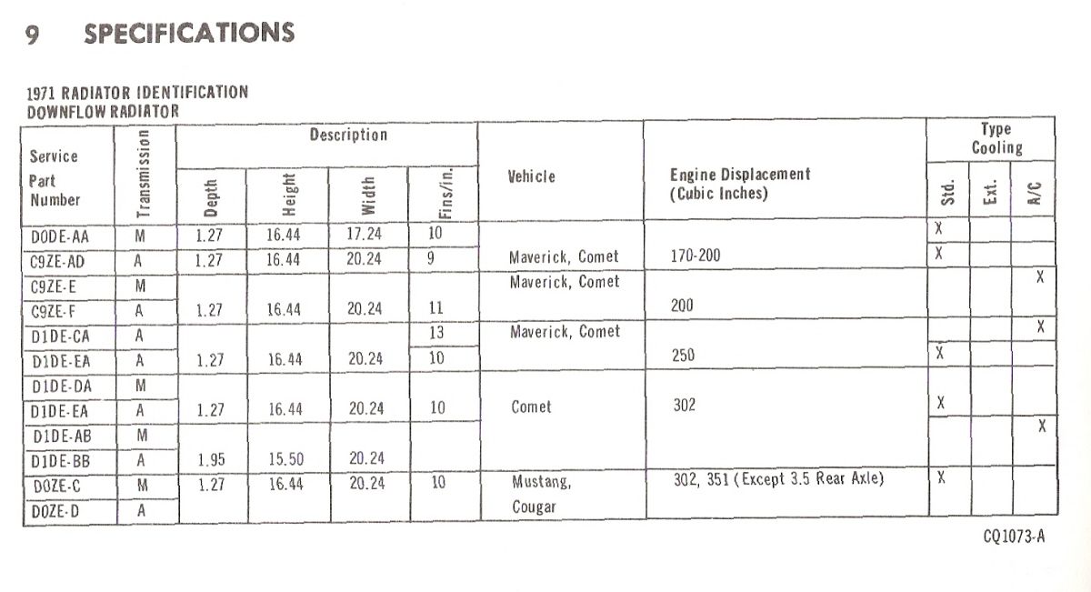

    Here's specs for 1971... HD radiators have more fins per inch but none are single core...
    Only singles I've seen were on 4cyl Fox Stangs or similar other makes...

    The chart lists a smaller & thicker radiator for 302(I believe three core), sometime in mid '72 it was replaced with a similar radiator listed for the 250, AFAIK the early radiator isn't currently reproduced...
