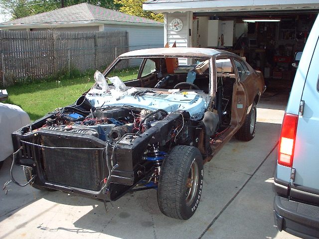

    I added a rear bar from PST to my Mav:
    I also upgraded to a larger front bar. I believe the rear bar is 3/4" and the front bar is 7/8", although it has been awhile since I ordered that stuff, so I am not absolutely sure. I have only recently gotten the Mav back on the road in the past few days, so the verdict is not completely in, but is does seem to corner better with far less body roll.
    I also added a Total Control Products coil-over suspension on the front, so that will also change the handling: (a picture from several months ago, but you can see the coilover )

  8. MavMark
    MavMark Mega Modifier
    779
    Detroit Area, Michigan
    I don't know why the IMG tags I posted above got interpreted as URL tags, but if you click them you will get the idea...
