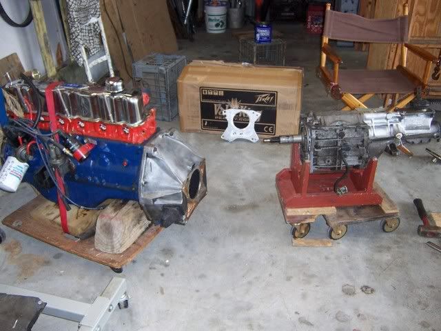

    Simplest way I know for Toploader to T5 conversion can use regular 84-93 Mustang V8 T5 with SBF adapter plate on the Maverick Six's stock Bellhouse for original Toploader (3.03) 3spd tranny. No special Pilot Bearing is required with V8 T5, any Small Block Ford/T5 Pilot will fit. Also you can use the later Fairmont/Mustang type diaphragm clutch for a smoother driving.
    http://www.ebay.com/itm/1965-1966-1...ash=item3f295efd04:g:-7wAAMXQqC9SM6td&vxp=mtr
    have fun
