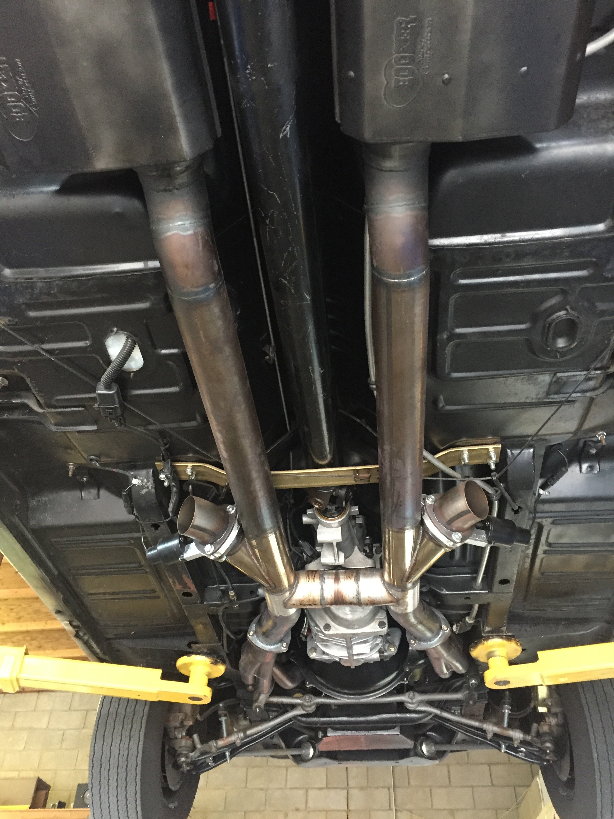

    currently Toploader 3OTT - swapping modded T5 bell with T5-Z
    [​IMG] .. .. [​IMG] .. [​IMG]

    TKO 600 with Quick Time bell housing. This bell is nice and small and fit up in there way better than the T5/Lakewood Bell combo. I think I have 4° shims in.
