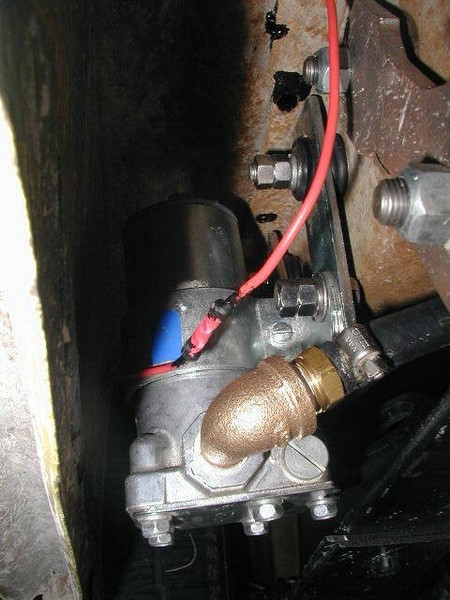

  3. scooper77515
    I installed mine hanging to get it lower, and have rubber bushing between a couple spots, so no metal-to-metal from pump bracket to the frame.
    Now, only noisy when I get below 1/4 tank and it starts to cavitate (still mounted too high to draw from mostly empty tank).
    Despite optical illusion, it really hangs about 3/8" away from the frame. Holley Blue.

  6. scooper77515
    The rubber pad/gasket they send with it is worthless. I even added several layers of extra rubber but still noisy. I started thinking it was transferring sound through the bolts, not the base-plate, so I hung it so the bolts are not directly in contact with the faceplate nor the frame.
    My idea could be done a lot nicer way, if you took the time. I didn't. Wanted it back on the road ASAP!
    I used regular wire thru-metal grommets, 8 pak at O'Reilly for just a couple bucks, HELP section.
    It is nearly silent when running. People say they didn't hear it until I point it out to them.
  7. mean_maverick
    looks decent to me. i hold function over form anyday :)

  9. scooper77515
    yeah, anything like that.
    Any piece of rubber wtih a hole in it should work. Or a piece of rubber that you PUT a hole in.
    Main thing is to make sure to have rubber on both sides, so none of the mounting screws have nut or bolt head touching metal.
