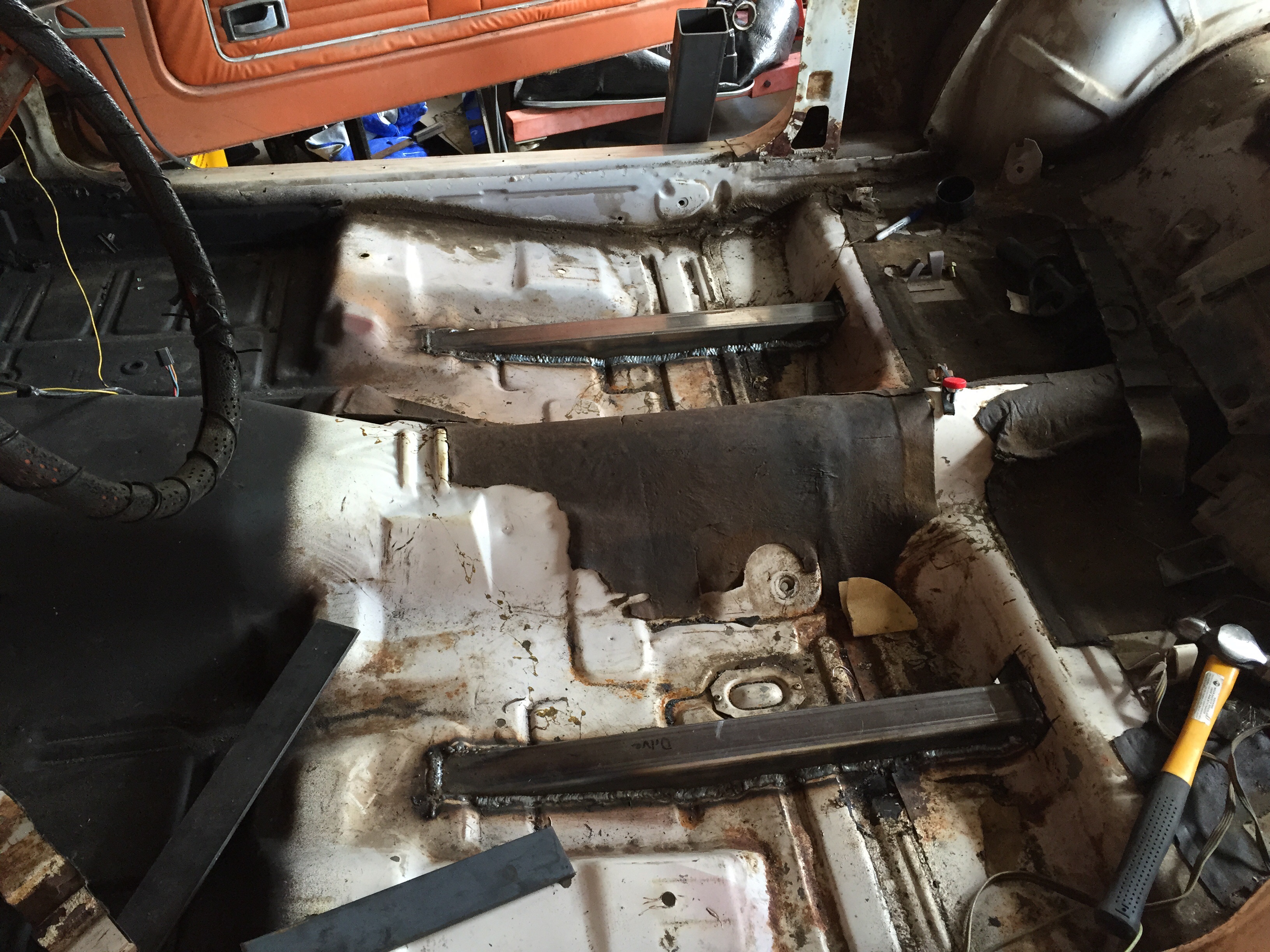

    If your car wasn't a factory V8 car, you will want to get a belly bar that ties the two front frame rails together under the motor, just behind the lower control arms.
    V8 cars sometime around or after 73 got shock tower reinforcements, too, but they are a bit more involved to install, if your car currently does not have them.
    Several people here have installed sub-frame connectors.
    Some go through the floor boards,
    Others follow the profile of the floor boards.
    A search will provide lots of info:
    http://mmb.maverick.to/search/2005246/?q=sub+frame+connectors&o=relevance
