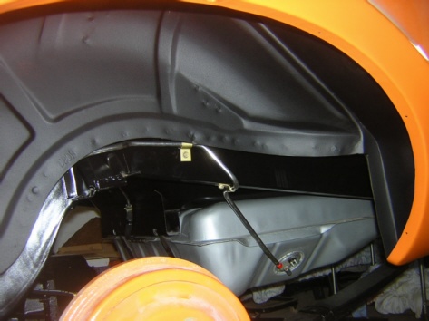

    I used Rust Bullet on 100% of it - then painted with Eastwood Chassis Black - than sprayed on undercoating as needed for a uniform look.

    i have been leaning towards the "Rust Bullit". (y)
    ...have bare galv. metal and didn't know if it would stick to it :hmmm: .

    18,305
    1,368
    Media blasted entire underside, epoxy primer, then Eastwood Chassis black on frame and underside, undercoating in Wheelwells.

    I didn't have a media blaster, so I used an angle grinder with wire cup and a die grinder with a wire brush for tight spots.
    As for the Rust Bullet, I have not found anything it didn't stick to. But time will tell I guess once the car is on the road and stones start hitting it. If it chips bad I will be disappointed. I do like the Eastwoods Chassis Black color. It is just the right amount of gloss.
