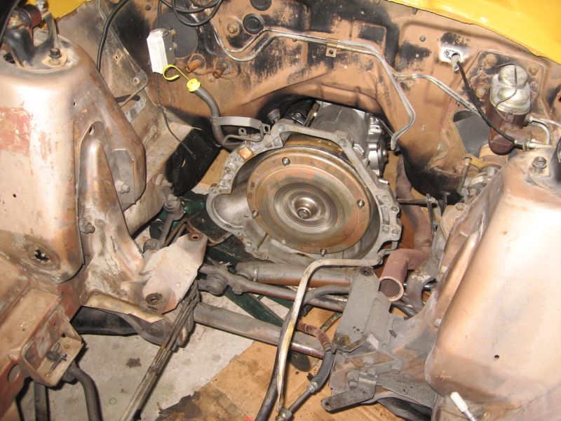

  5. Krazy Comet
    7,713
    2,432
    Here's a pict of mine just after I pulled engine, yours does seem correct...Also I don't have more than 1/2" clearance from W/P pulley to fan motor...
    Any chance there is supposed to be a off set bracket the clutch linkage bolts to??

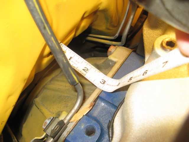

  12. Krazy Comet
    7,713
    2,432
    Nope, mine is automatic...
    Lets settle it once and for all, what's the distance from back of block to dimple in firewall??? Mine measures approx 3 1/8"....
  13. koldham
    koldham Member
    Feb 21, 2009
    99
    40
    Walnut Grove, Gerogia
    1973 Maverick
    i have a bit less than 3 inches... maby i was sent the wrong z bar frame mount.
