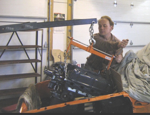

    Oil Pan Fit for 347 . We cut up another stock oil pan and added more height to increase the oil supply .. added another quart and a half . Requires a little welding and splicing but it helped a lot.

    Hi Everett: I bought an Milodon Oil Pan ( still got it ) originally and we found it took up too much room because it had the bottoms that extended outward both directions. We used the Milodon Oil Pick-up and made OUR oil pan the same depth as the Milodon by cutting the sump area off and adding a metal strip about 1-1/2" or so wide. We also put a shelf in the front to prevent the oil from rushing to the rear of the car when accelerating . After we finished our welding procedures we cleaned it , filled it with water and left it overnight to check for leaks . We found " one " and when that was plugged (re-welded) we installed the pan.After filling our engine with oil we found a Longer dipstick
    and placed three small center-punch marks on the stick to indicate the different oil levels. Worked great and I always had a little more reserve in the oil department. This work gave us the room we needed without crowding.
