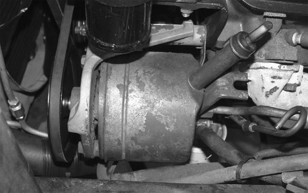

  5. Jaybee
    Jaybee Member
    Feb 17, 2019
    515
    243
    Hampton Roads, VA
    1974 Maverick
