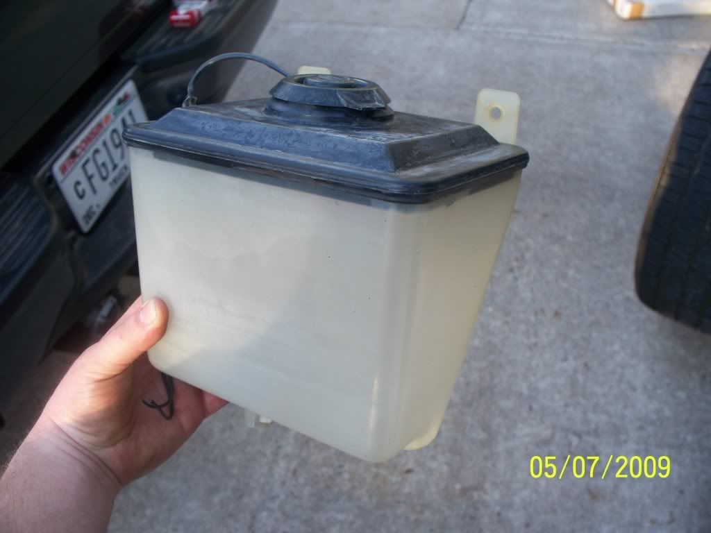

  10. Joe Dirt
    Seen a few good decent ones go for sub 30.00 on the cobra board lately
    heres a torino jug looks to have the shroud
